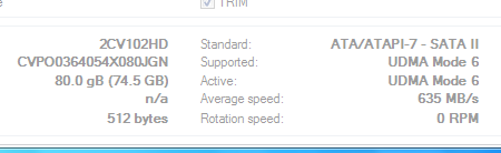

I started with a 80GB (74.4GB) and 10.6GB after updates and a few programs with 63.7 free. Awesome
- 3.PNG (9.45 KiB) Viewed 17969 times

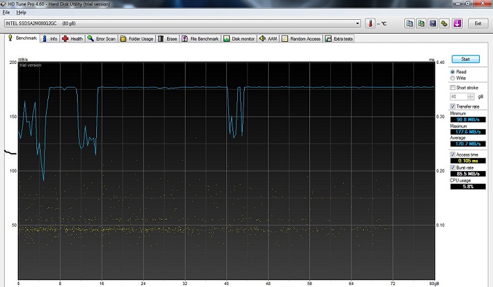

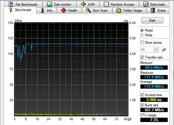

Note that the sata-1 interface is reducing performance,in comparison to the same ssd in my Thinkpad with a sata-2 interface
Your average 115MB/s
Mine 170MB/s
The throughput is still double a 7200rpm hard drive
My previous Seagate Momentus XT hybrid hard drive was rated @83mb/s btw
Mine 170MB/s
- test1.jpg (81.78 KiB) Viewed 17945 times

I see what you mean. Is the MK2 and 3 sata-1 interface too ? Some where I have the test results from my old WD Black 320gb7200rpm drive....would like to compare them.

, looking for the intel ssd toolbox software. Mine never came with it. Did you do a firmware update on the ssd ?
Re: SSD IN A CF-30
That was a few days ago, I don't remember if I upgraded firmware
I have the ssd toolbox and the Optimiser is run and fine + the tuner
The opimizer states that the latest firmware must bbe on it to run ,and it completed whatever it does
My firmware listing looks different than yours
My drive may have been a later model ,I have the latest firmware,yours is out of date
2CV102M3 , and yours is 2CV102HD

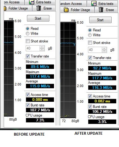

Just did the firmware update. Here is the before and after results
- HD TUNE-CF-30 NEW.jpg (82.96 KiB) Viewed 17873 times
