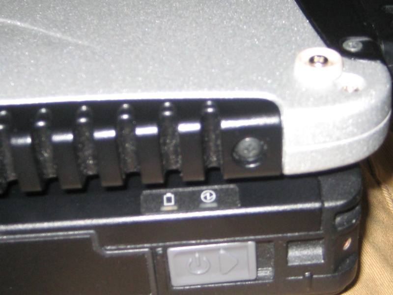

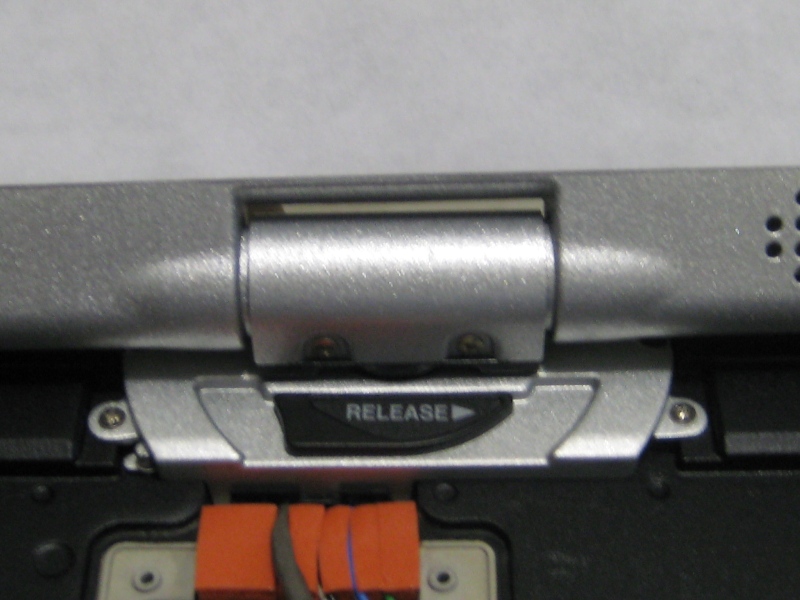

I bought a CF-19MK3 unit for parts thinking that I can use it to replace the whole casing and LCD panel of my beloved CF-19MK1 model on which I have proven a reliable unit when I travel a month ago and it needs a major make over to serve me well in the near future. But I soon I open the box I relialized that it is different animal. The whole LCD casins has a major changes. The base has been reinforce a bit bump of a bump out and all the screws are bigger than the other model(MK1,MK2). The top hat plastic covering also has changes. The screws on both end was then trnsfer to the top instead of four on itside it is now two at the top. The picture are included see for yourself. This unit is not working. When I open it I think somebody are trying to upgrade the ram and damage the battery cable connector on Mbo. and the plastic dim holder with the switch for wireless is missing. When I hook it up to AC of course with Ram, the brightness LED light is blinking and when I push the button it does nothing. I know it got something to do with the onboard power circuitry and I am trying to find out if there is mark for burn or blown area but I can't find it. I know that it must be one of its IC but I have no way of testing those IC's. I have no schematic for cf-19MK3 and it is has a big different from MK1 and MK2. I am walking on the dark here on troubleshooting the problem. Has anybody here has an schematic for CF19MK3 or idea and Yes! all fuses are fine.

- 2010 new yr 1157.jpg (161.06 KiB) Viewed 19163 times
- CF19MK3
- 2010 new yr 1159.jpg (188.67 KiB) Viewed 19163 times
