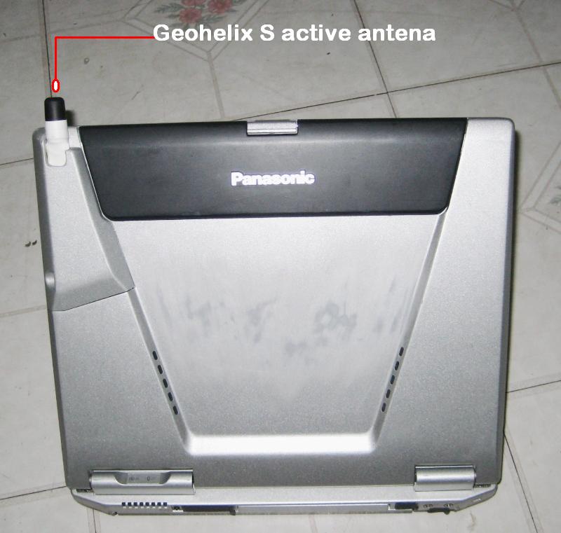

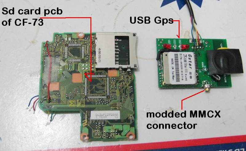

Whats up, man! been to busy now. it start to catch up again from my day job. Anyway, I've got a chance to work on my cf-73 last sunday and I found out that the problem is the antena. i insatlled a new Sarantel S active antena onto it and it works perfect. I need to modify an antena connector on the gps engine as originally it has none(no connector for external). The only remaining task on it is to pour a bit of rubber mixture on the antena base as it is not good lookin. BTW, Its a pain in the as...on tracing those usb line on the sd slot board on this machine. I needed a good magnifying glass to make it done. Here is the photo for reference:
modded gps engine receiver
2010 new yr 008.jpg (70.53 KiB) Viewed 12340 times
LID will be painted later
2010 new yr 007.jpg (66 KiB) Viewed 12340 times

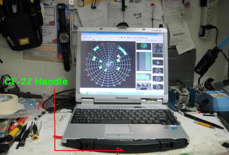

using gps viewer utility
2010 new yr 001.jpg (65.32 KiB) Viewed 12340 times

Why the cf-27 handle?

Hi! The cf-27 handle has d ring for strap thats why I installed on it.
I need to installed the bump out WWAN case for an antena insatllation only becoz if there is none its gonna be dificult to install the sarantel antena as there is not enough thickness on the LCD lid to cover its antena base diameter. I tried different antena on the palm rest but to no avail.

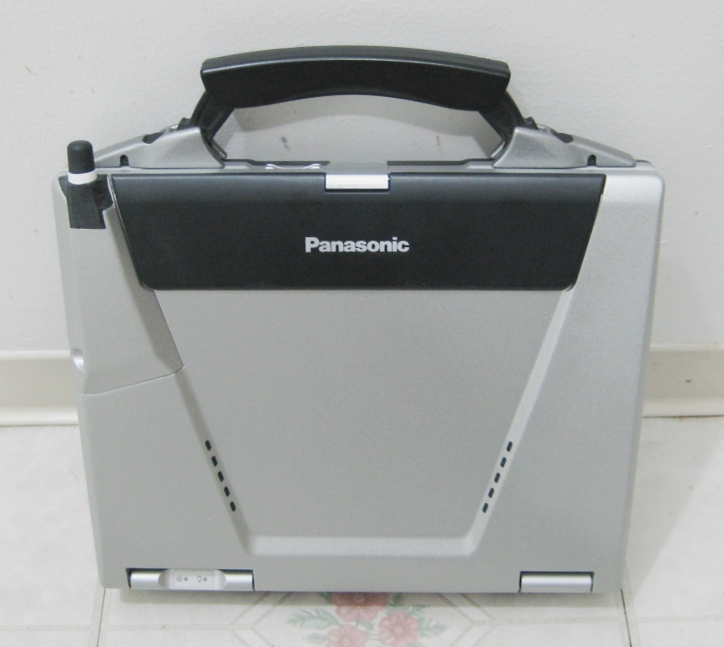

Well then, here is the final product of to what I've done on this unit. :pbjt: It is also available for sale now on Ebay. Its costly as I spent to much manhour on it. :read:
Cf-73 with 20 channel gps Sirf III
2010 new yr 03411.jpg (167.99 KiB) Viewed 12266 times
