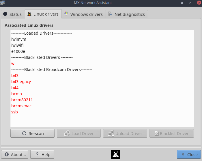

Is this a 8260 wireless card? Found to be problematic in my CF-54 MK2.
This works in MX17 after deleting Network Manager. It was shutting down every so often.

On my CF-54 I deleted Network Manager and cured it shutting down when it felt like it.

wl has a bug with some cards. My CF-54 has wl blacklisted. Do a search for wl.
