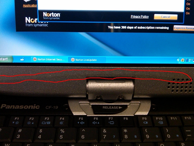

See the attached pic... it seems to be creased somehow and it bumps out a little bit. I can physically feel it in the screen of the CF-19.
The hinges are tight and whatnot and I don't think that this has been abused, but was just wondering your guys opinion on it.
Should I be concerned about this "crease" thing?

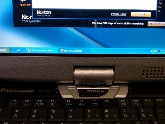

- Unedited.jpg (227.22 KiB) Viewed 23384 times
- Edited.JPG (232 KiB) Viewed 23383 times
Re: Should I be concerned about this "crease" thing?
Rob...Its normal for cf-19 as it is part of the screen bezel designed to reinforce it from bending. Its like an structural design. Mine has the same figure too. Don't you worry about that.
The question is why they made it so obvious specially outside while they can make it straight all the way.
so is the crease something that is molded into the plastic? or is it just something that has started happening?
It isn't plastic... It's metal (magnesium alloy to be exact). And the only reason I asked about it is because the other CF-19 I have does NOT have this...
I disagree with Teo on this Rob
Is this happening on that cheap cf-19 that you just bought?
I have seen this defect start on one of my cf-19's it is something to do with all the stress that a single hinge has to handle
Alex, you F*CK TARD!! I EFFING HATE YOU!! You got me freaked for a little bit man!!! Seriously!!! This laptop is for Samantha so it better be DAMN CRISP or I'll never hear the end of it!!!
As I have seen and inspected it is a manufac..ing defect on the first series of cf-19 (MK1) and probably seen by quality control inspector and clear out the next to present series. I have one bezel with a crack shattered screen and see in the inside and it has same stage but as hard it can't be coz by folding and bending the sreen as it is hard as steel with no crack at all.

I have noticed that this unit with this weird crease thing has MUCH tighter hinges than the other unit did... Which in my mind tighter hinges are a big + in my book.
Probably Alex is right! as my comment above is only my observation. But theoritically he is right. As this area of the LCD is one always handling the pressure from folding close and often.
Rob... thats why my cf-19 is on ebay now! Lol
edit: I also notice the dif..nce between the cf-19 and cf-18 lcd bezel. On cf-19 the reiforce vertical layout that goes side to side below was cut out to give way for the speker without any other reinforcing link to the bezel when it move or fold. Thats how it explain it causes this thing to happen.
