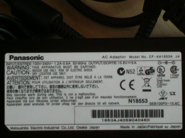

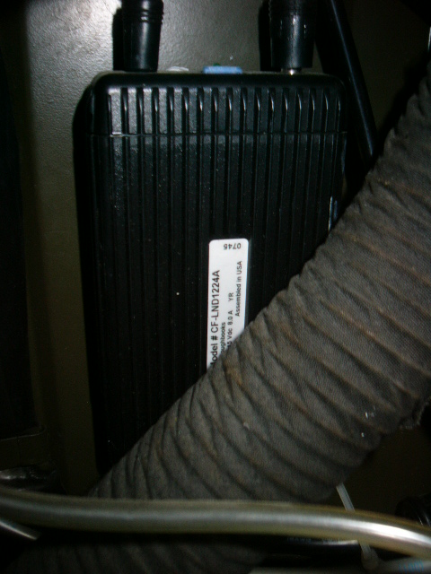

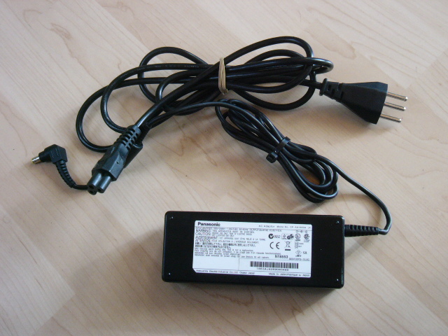

Please post a photo of the label of the home charger and the car charger.

But i have the Original Home Charger from Panasonic and in the Car the LIND Charger 12-32V. My Car ist running on 24V.

Now are the Pictures.
- Car Charger from Lind for CF19
- P1060489.JPG (144 KiB) Viewed 20530 times
- Original Charger for Home Use
- P1060488.JPG (137.17 KiB) Viewed 20530 times
- P1060485.JPG (135.08 KiB) Viewed 20530 times
Re: GPS signal reception problem
Thank you for the photos.
Many people use aftermarket chargers at the wrong voltage.
I just wanted to verify that you have the correct chargers first.
Those are both fine.

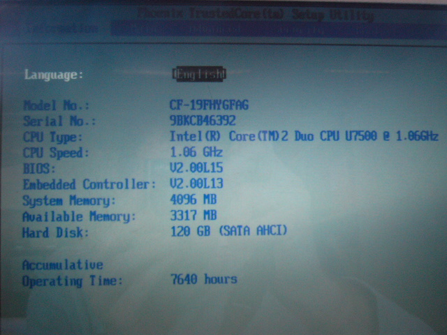

Next question.. What bios version? Post a photo of the main BIOS page if you can. I am wondering if you have a custom BIOS that shuts off the gps power. The antenna connection and switching is mechanical only, but the main gps power is controlled by the BIOS.

Here the Photo from Bios
The problem is wherever I am.
When running on battery, the GPS runs properly.
Whether in the house, in the garden or in the wide mountains.
As soon as I connect it to the power at the same place, the signal coincides.
With very good signal with battery I sometimes have a signal with power connection. But only weak. Of 8 saddles remain just 3-4 left or it breaks completely together to 80%

It is not a custom BIOS. That is good
