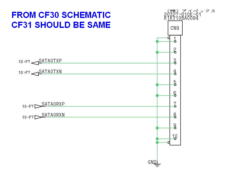

From the schematic, it appears all we need to do is figure the pinout from the caddy connector. run wires to a sata connector for data and power. I don't think we need any components at all.
CN9 is the CF30 motherboard connector for the HDD caddy cable.
Guessing that P and N on the end indicates positive and negative. If I can figure out if T or if R indicates A or B, the rest should be simple.
SATA0TXP
SATA0TXN
SATA0RXP
SATA0RXN
SATA0TXP
SATA0TXN
SATA0RXP
SATA0RXN

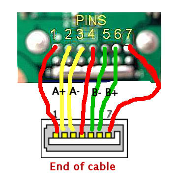

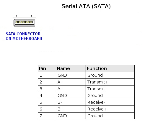

This indicates receive and transmit lines

Thanks,
I plan on building a cable assembly using the CF30 hard drive caddy connector going to the standard male SATA connector that you find on a hard drive. Should not be any mods the motherboard itself.
The motherboard schematic just shows me the pinouts.

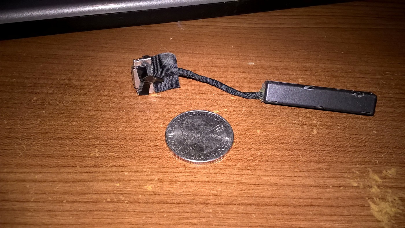

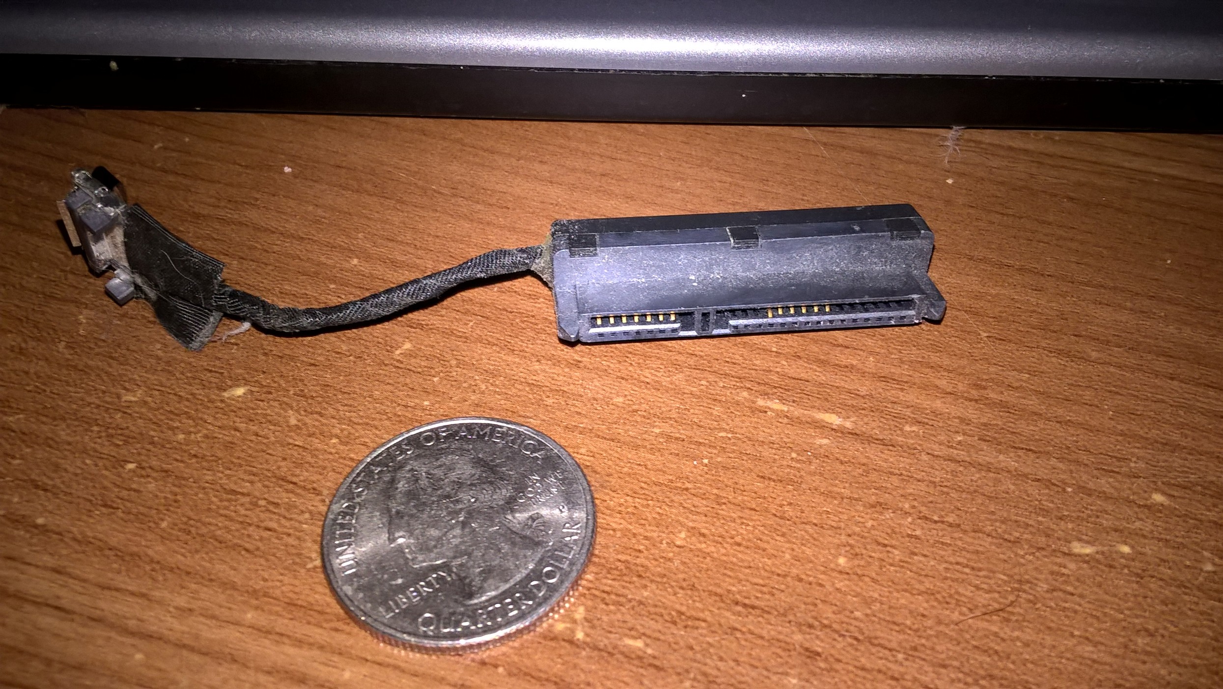

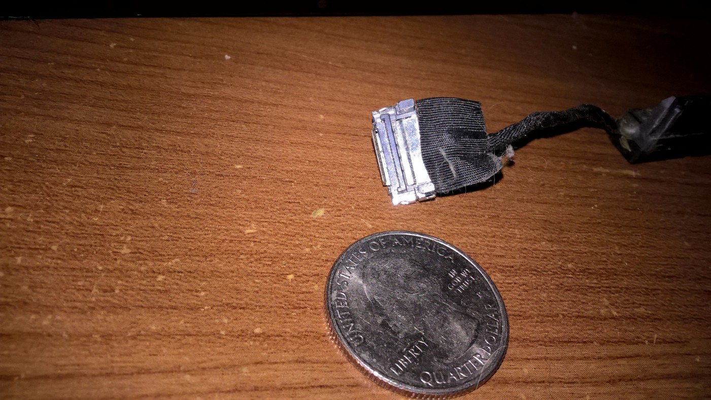

Have you thought about the cable connectors used in like a HP DV6?
Re: Hard Drive Caddy adapter.
Bill_TN wrote:Have you thought about the cable connectors used in like a HP DV6?
What do those look like?
I don't own a HP computer
Ummnnn...... Gimme a bit and I'll post a pic.
Bet these are going to be BIG.
- A__FAEE.jpg (399.93 KiB) Viewed 16340 times
- A__C34B.jpg (939.85 KiB) Viewed 16340 times
- A__8B53.jpg (379.2 KiB) Viewed 16340 times
Yup. But hey good detail.
