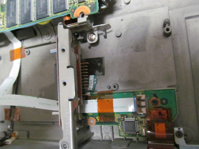

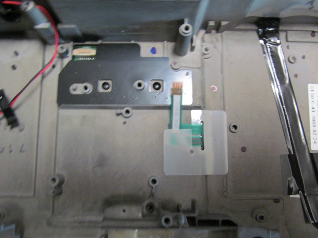

I found you a parts beast or two. (or six) You can see where the touchpad cable comes through the metal then folds and goes on top of the pcb. Basically hidden from view..take that back..You know you may be able to look in the battery door using mobo flick as reference.
The one with the bad mobo has a pretty good looking touchpad. Has more stuff with it. Two for price of one.... pay the shipping.
Hopefully we can fix yours without repair being necessary. You may have to pull yours apart to check the cable.
I was looking for my CF-29XP caddy and stumbled on these. Almost literally.

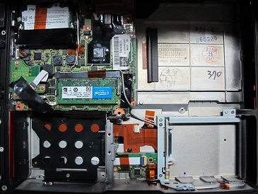

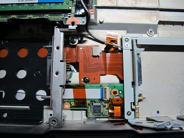

Here's a couple pics of inside. Not sure what I'm looking at but similar to your pics Jeff.
Rich
Rich

Re: Touchpad and Touchscreen inop
Image 003 the cable in under the battery connection. To see clearly pull the black cage and peek under the horizonal white cable. Where the cable comes up is under the black cage.
If you understand it that silver piece is fairly simple to remove. I always pulled the big screw then lifted on the mobo to identify the screws holding the mobo down. Just the ones near the hdd cage. There is one screw under the ram. (Some hold bits on to the mobo and some hold it down)
The silver bit is socketed upward into the mobo. Re-install is line the socket up and press down while installing the screw in the mobo which tightens the connection. Reverse osmosis not a technical manual in sight.
Stuff to do here. If you get hung up give me a call later.
EDIT What's that black tape covering up....someone has been in there. END EDIT
The black tape is covering a small four wire lead that goes to a white plug on the corner of the ram. I removed the tape, not sure why it was there, but no damage.
I checked eBay to see a picture of the touchpad, and have been studying your pics against mine and I see what I need to do, just trying to fit it in. Busy at work and this can't be a home project.
edit - Just got some things moved around and checked some connections, can't find anything loose or damaged, now what - end edit
more edit - also thinking of returning - end more edit
