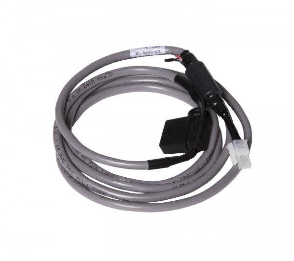

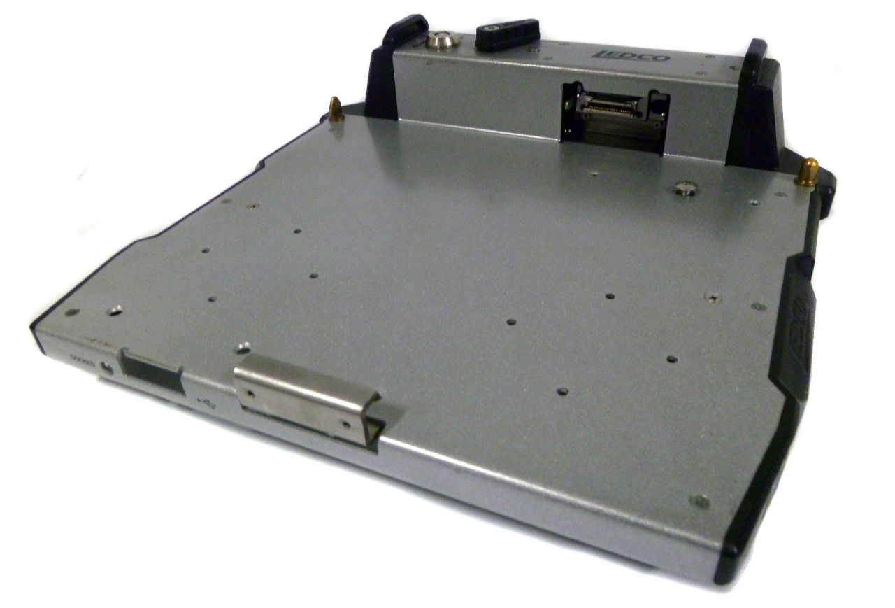

I cant find a number on it, but it has a power cable similar to this one. So I am assuming (dangerous) that this cable would have been connected directly to the cars electrical system. So do I just get a laptop power supply and cut off the end and splice it to this cable?
Both images are from google, easier to get.
- Ledco dock.jpg (90.05 KiB) Viewed 16299 times
- power cable.jpg (118.72 KiB) Viewed 16299 times

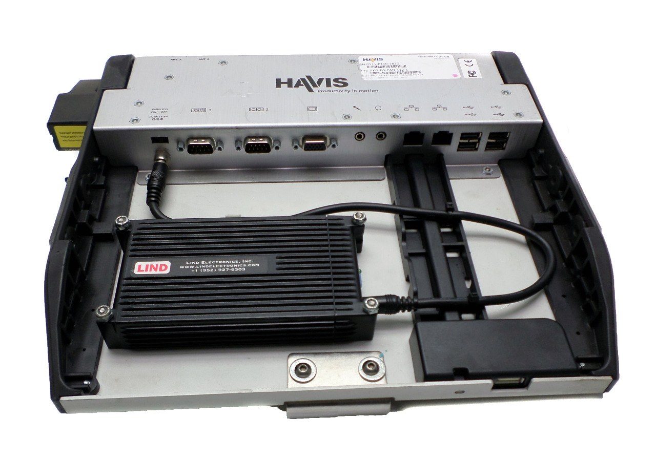

Please post a photo of the bottom of YOUR dock. Not a Google grab. I need it to have specific information.
Look at the picture I posted. It is the underside of the dock. See the black box marked "LIND"?
That is the actual power supply. It takes 12vdc from the vehicle and converts it to 15.6vdc for the dock/Toughbook to use.
All you need to do is remove that power supply and connect a standard Toughbook power supply in place of it. 120vac to 15.6vdc.
Both power supplies probably have the same output connector. In most cases no wire cutting will be needed.

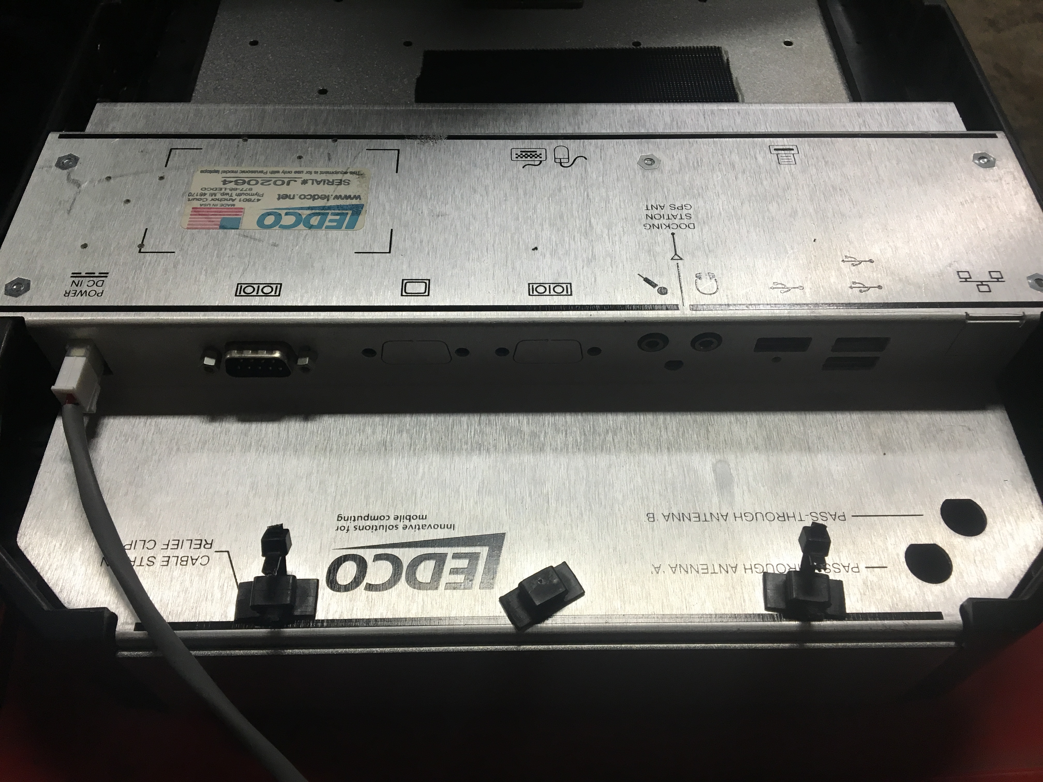

Re: Ledco Docking Station
I hope this picture helps.
- image.jpeg (2.54 MiB) Viewed 16288 times
That's going to take some research as the power supply is internal.

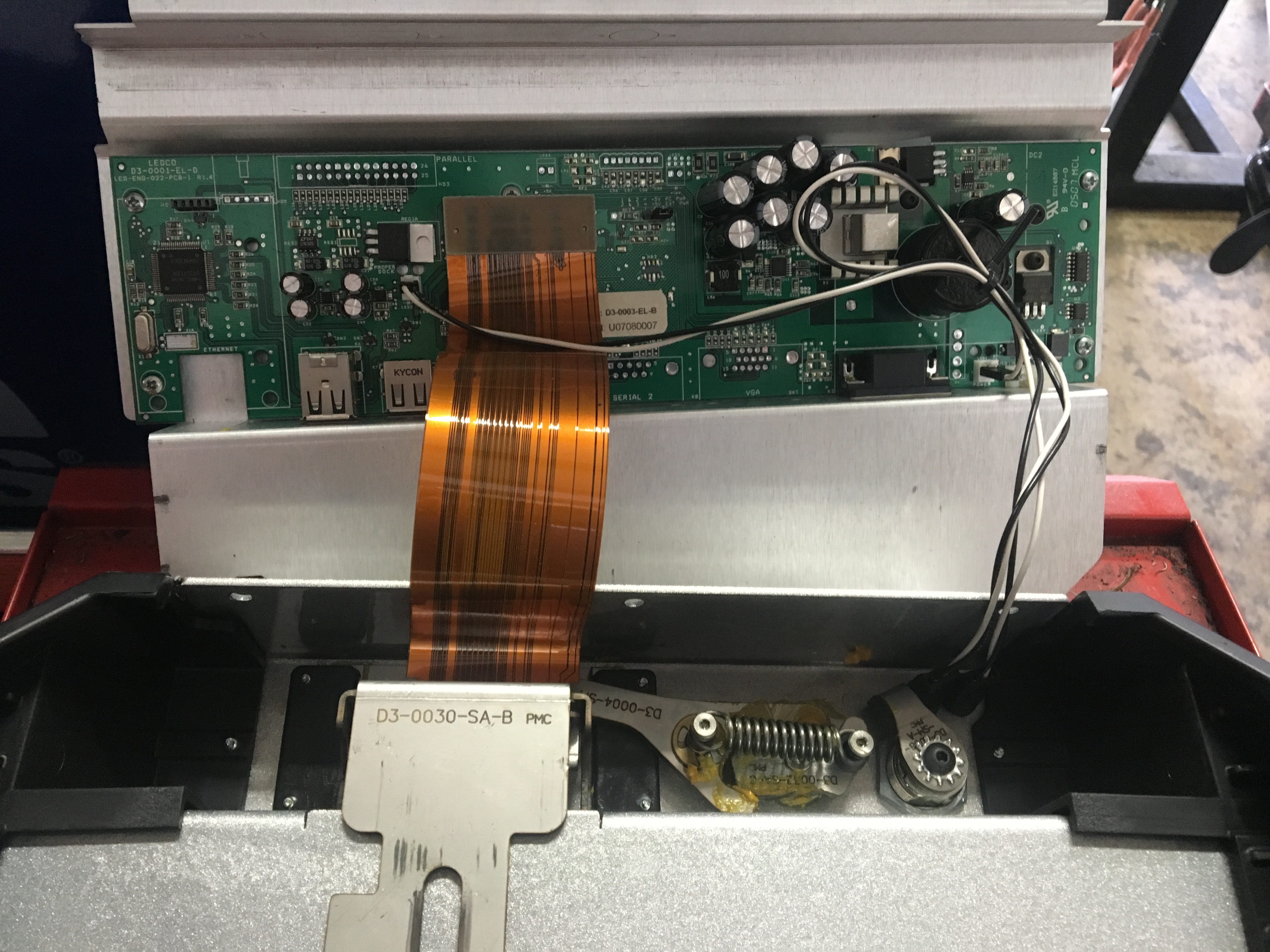

Here's picture of inside. Sorry they are so big, from my phone.
- image.jpeg (2.15 MiB) Viewed 16280 times
When the boss leaves.... Funny, because I have been there.
With that particular dock, your solution may require a 12v power supply.
My best guess is a decent 12v power supply with a minimum of 10 amp regulated output.
