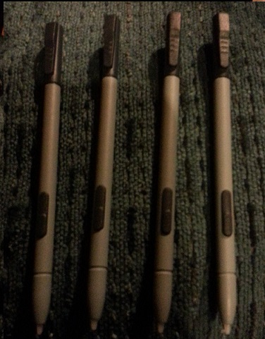

Re: Can I still use digi screen?
and that is just what I didShawn wrote:That is a good price....Good to have a spare or two.toughasnails wrote:Yes but I am at work now. I have a link to them at home....I paid around $10-$15
- digitizer pens.jpg (91.82 KiB) Viewed 20811 times
I think these are the same as the ones I got. I PM the seller so when I find out I will post back. Here is the link http://www.ebay.com/itm/Toshiba-Tablet- ... 35d85b5c60
This is the search I used http://www.ebay.com/sch/i.html?_from=R4 ... C&_sacat=0
There is no hole at the top of the pen for the tether but I think you know how to fix that.
I think I put up the different pens you could use in the CF-18 thread, just need your own hole in the toshiba pen. No tether hole.
(cut and paste from CF-18 thread)
PEN PART NUMBERS
Same as Wacom M200 will fit the digitizer slot, but no hole for the tether.
Also with out the tether hole is this PA3317U-2ETC Toshiba pen.
PEN PART NUMBERS
