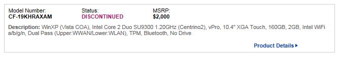

I added GPS to this machine using Panasonic original parts and then tried to switch the 2nd RF pass-though in BIOS to GPS once I already had it reassembled. No such luck- not an option on the Mk3. I looked on Toughwiki and I see the wireless options digit has specific configuration choices for WWAN cards and also the 2nd RF as GPS pass-though. The question is whether this requires different hardware (i.e. pass-through board) or can I simply reconfigure mine to GPS? I did look at the pass-through board while I had it open to make sure that the GPS antenna was connected, since it was not factory equipped. I THINK the GPS is already connected to the board if I traced the antennas correctly and I also saw that there were unused connectors on the board. I am hoping I just need to swap the connectors around to change the output. Before I crack the case again to experiment, I was hoping someone had already done this and could confirm.
