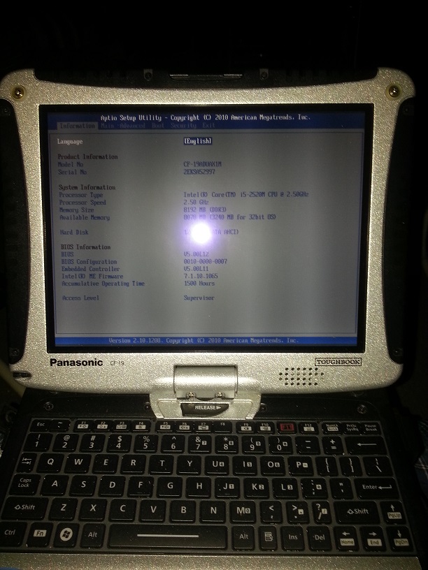

For whatever reason I think the new mk5's screen looks dimmer at full brightness and it looks a bit washed out (less contrast) than the mk3. This is even during bootup/BIOS screens. The black border around the LCD seems larger as well. (I'll take a few comparison pics soon.)

As for the screen, no it doesn't. Mk3-mk7 is LED, mk1-2 are CCFL.
And yes, the screen indeed looks slightly too high contrasted here too.

Yes same here. At work now but will check out the border in the AM.canuckcam wrote:

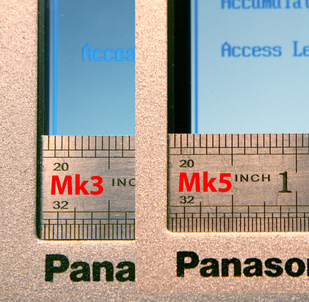

So this isn't proper scientific/100% aligned and my ruler is kinda off, but I tried my best to look perfectly square to the screen.. and well, here you go... so the mk5-7 screens ARE smaller than the mk1-4!
The edge in the middle of the border area is the edge of the screen protector.
