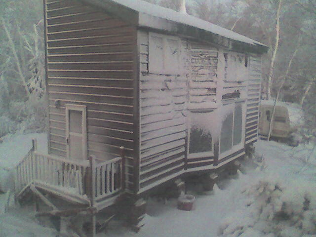

The cottage is already built, a lot of thought went into going 12V vs higher, 24V was tempting... It is budget oriented and while the copper cost a bit more(meh), using cheap(or not) 12V appliances, relays, chargers(gas gen), isolators, and disposable inverters won out. (Not the popular choice)
There are 1860Watts of panels installed, but half the year they are partially shaded. Keeping power use low, allows for reflected/ambient light charging. 4-6KWh/day in the summer months.
That's my reasoning anyway, it really $uck$ to have to buy computers to test them! hehe
