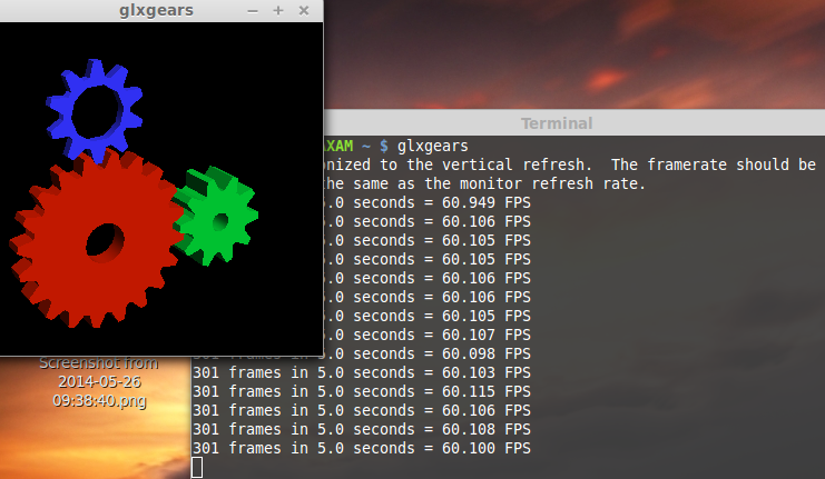

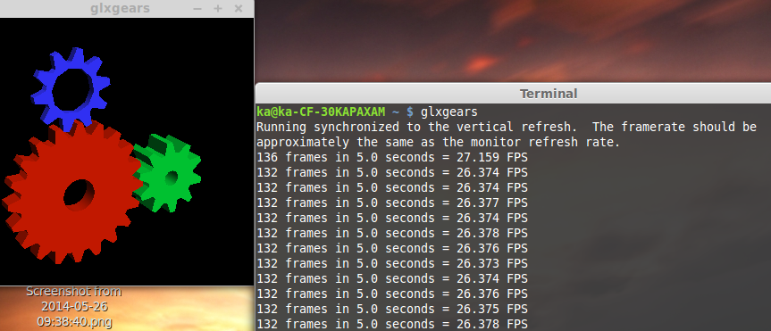

One step at a time. Ran accross reference to glxgears ..."most distros have it loaded" so take a look.
I was thinking refresh rate was the culprit here...what say you? The machine in use is in the file name. Same drive, Mint 17 SSD used on both.
