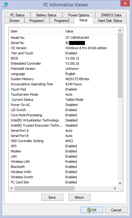

Windows 8.1 Pro confirmed working on my CF-19KHRAGAM including the Sierra Wireless MC7700 WWAN aircard!
Essentially just download the Windows 8 64 bit drivers for the CF-19 mk7, and follow the installation PDF. Windows will prefer some of its own drivers over the Panasonic-provided, use the default Windows drivers.
Below is the report with driver versions from the Panasonic PC Info Utility.
videonerd-drivers.txt
(6.35 KiB) Downloaded 996 times
