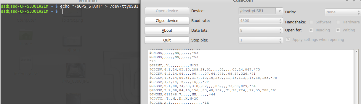

Found this a while back.
This command in terminal, starts the Gobi reeling off GPS numbers. There is another way but it's cumbersome and requires a dual boot system. I won't go into that, it's available on internet.
Here we go.
As you see I have CuteCom loaded.
Here we go.

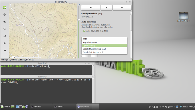

Cutecom:
Morgan was right. I use Cutecom to work my way through the numbers (devices) until I see gps information scrolling.
So I will finish with a picture. BTW this is a CF-53 running Mint 16. FoxtrotGPS and Cutecom are available in synaptic package manager.
Best wishes,

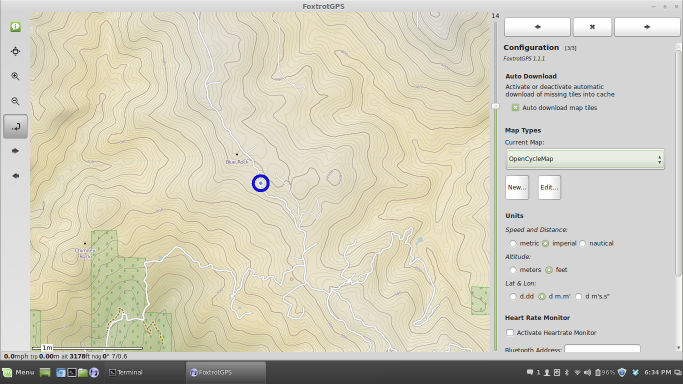

O.K. back from the barn.
Took 53 out on the porch. Followed my instructions, starting w/ killall.
Less than 4 second lock.
