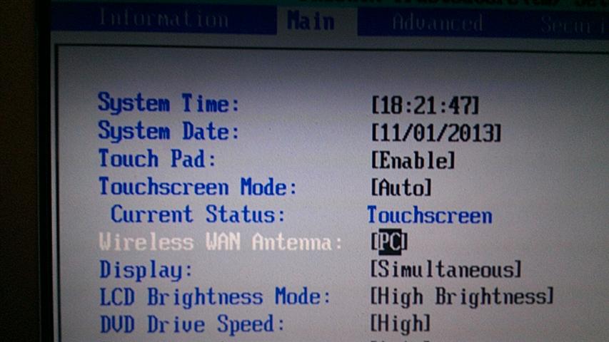

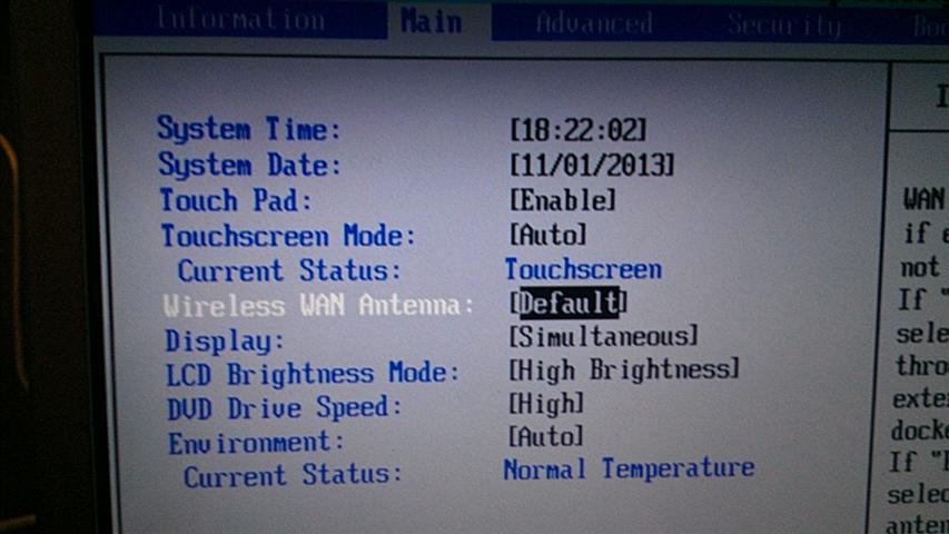

Yes there is a setting....on the CF-30 not sure about the 29jerds19 wrote: I'm fairly certain that by docking the computer it is ignoring the built in antenna (pop up above the screen) and trying to use the one in the dock, however I don't have one in the dock so I get an awful (if any) connection.
My two questions are:
1. Is there a way to retain use of the Toughbooks antenna even when docked? (jumpers, programming?)
2. If not is there a good antenna someone could suggest?
Thanks in advance for any advice.
Enter thr Bios By pressing F2 at boot. Arrow over to the MAIN page. Arrow down to Wireless WAN antenna. The choices are Default or PC. In the PC setting the dock antenna is ignored

Re: CF-30 / ignore docking station WWAN antenna
i58,
I saw this yesterday and thought I was losing my mind....CF-30MK3
The POINT...the sled must be mounted for this to appear. Also resetting the bios to defaults may change it. Haven't tried that yet. BUT this is the "proper" way. No fun, but proper.
Thanks,
EDIT Guess what? Setting bios to defaults returned the wwan entry to.......default....who woulda guessed. J
AWESOME! Exactly what I needed, problem solved, ya'll are awesome!i58sr wrote:Yes there is a setting....on the CF-30 not sure about the 29jerds19 wrote: I'm fairly certain that by docking the computer it is ignoring the built in antenna (pop up above the screen) and trying to use the one in the dock, however I don't have one in the dock so I get an awful (if any) connection.
