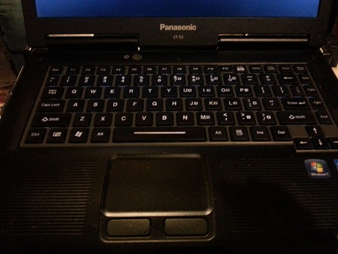

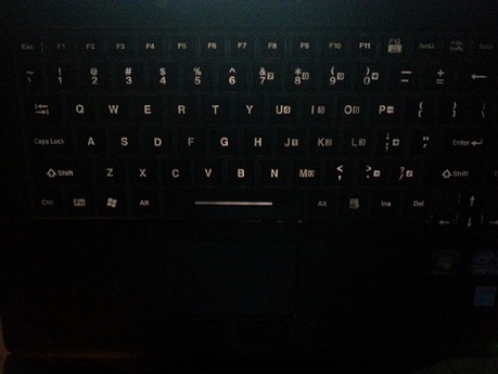

Well I finally got around to installing my spare emissive keyboard in my 53. This was very easy to do and only 6 screws to take out. Four screws that hold the keyboard and 2 under the keyboard. The hardest part was pulling off the keyboard because it is being held down by double face tape. The one I used was from a old CF-29 (CF-30 will fit to) that I parted out. When hooking up the lines the main thing to remember is to pull out the narrow cable and flip it over (longest one). This line gives power to the keyboard. In all it took about 15 minutes to install. I will post a picture later of the lines to give you a better idea how they should look.
- CF-53 Keyboard.jpg (46.13 KiB) Viewed 13734 times
- CF-53 Keyboard 2.jpg (73.15 KiB) Viewed 13734 times
