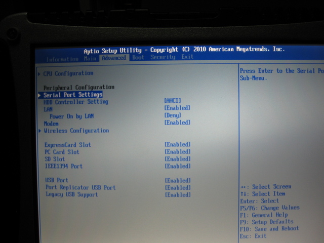

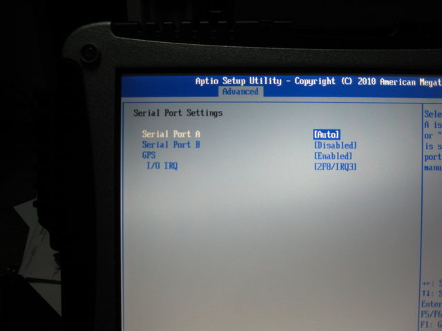

I'm going to stick my neck out here and say your device is a serial device in Linux at ttyS1 if it's wired properly. In Windows it should be found at Com3 and may require a serial to usb driver which I think is built into (packaged with) the Ublox software. (Teo? are you there?)
note: See my PM or email note re: grounding to the chassis to show up in bios.
Good luck Chris,
Here's the bios view from a MK4.can anyone tell me to wich part of the bus the smal uBloc gps board s connected - for me it does not look like a pli-attachement more like usb/serial according to the number of lines possible to me. can anyone confirm this or give me some detailed info??
Good luck Chris,
- IMG_0017.resized.JPG (99.13 KiB) Viewed 19336 times
- Scroll to serial device hit enter for the sub-menu. May be different on MK3.

Jeff! your correct! The second slot mini pcie( WWAN slot to be exact) on CF-19 that Cris mentioned when used with the GPS uBlox-s5-004(mimi pcie) need a driver from USB to serial port. Its differ from normal serial port that Cf-19 allocated for stand alone gps port. Sorry! I am not really good in english thats why I can not explain properly.
