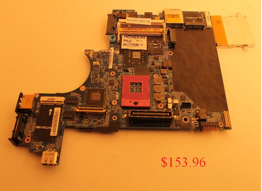

Well this is the only idea I have...sorry but I think you need this http://www.ebay.com/itm/370628681066?ss ... 1438.l2649

- Dell.jpg (129.16 KiB) Viewed 22811 times

However, back to the point at hand. It appears someone had been screwing around inside before I got it. When I took it down to the mobo, I noticed a screw or two missing and when I found the duct tape over the BIOS chip I was pretty much convinced. When I pulled the tape, the BIOS chip came out and one of the legs had broken off the chip. I am going to get a new pre flashed chip and see if that makes a difference.
