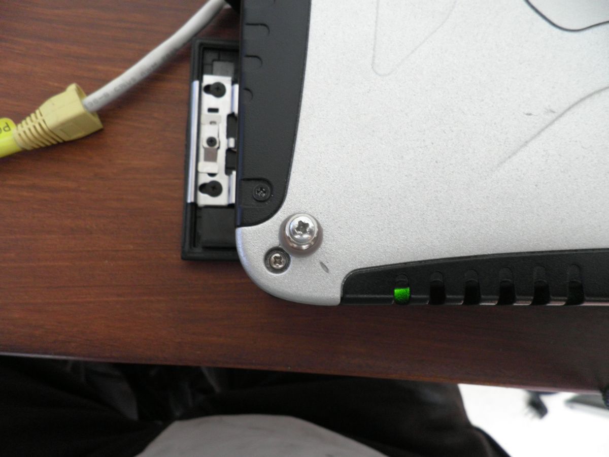

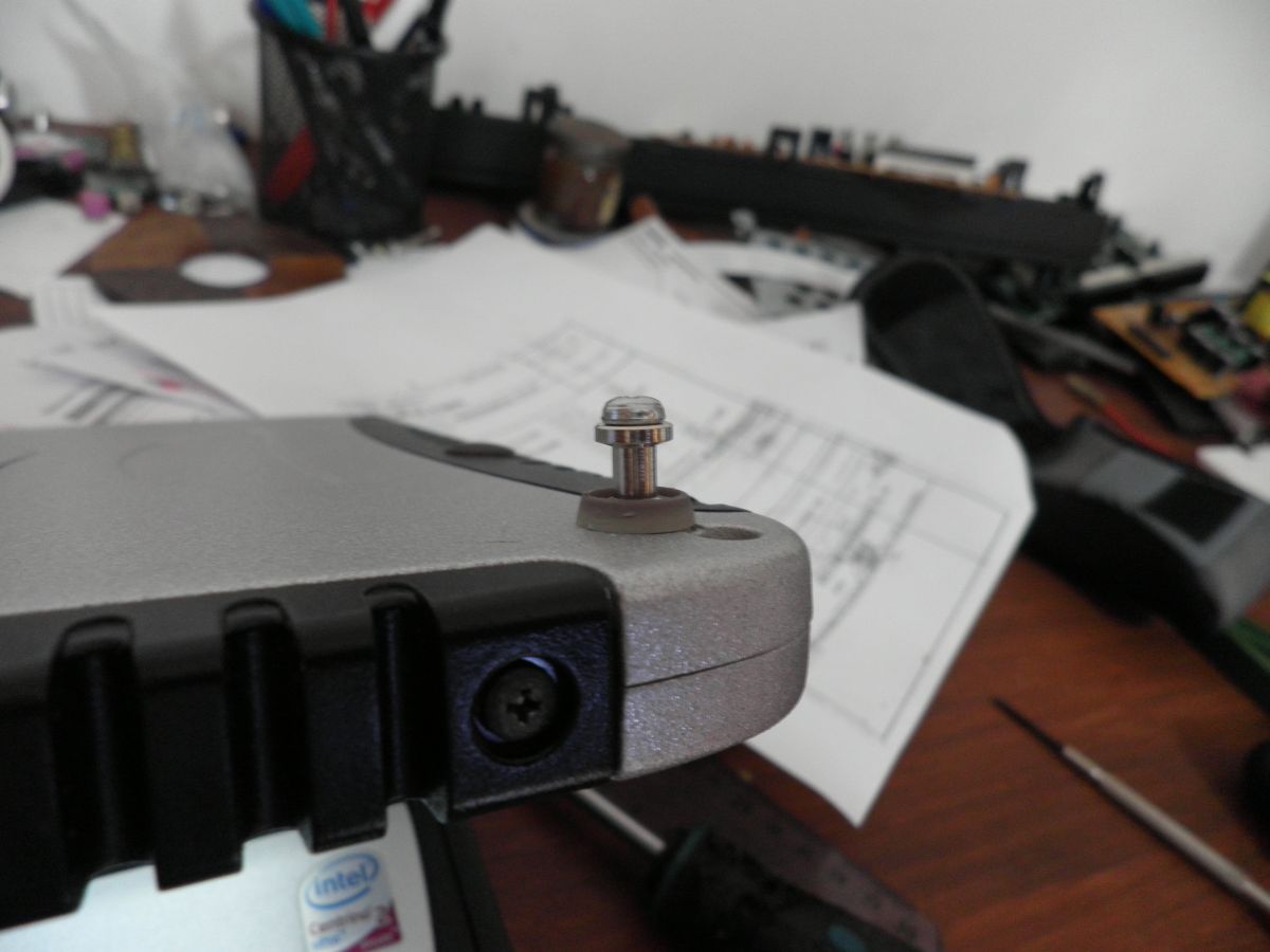

Hi All, my Mk3 arrived today, see what you all me about the screen, its fantastic, this one has I think factory GPS fitted, on the lid its got 2 long screws so you cant clip the screen down when its turned round, what do you think these are for, maybe some sort of vehicle mount ? the main thing is how do I change them, Ive tried to undo them and the screws turn but dont come out, I dont want to break anything

I believe the stock screws at that position have a nut inside the display case. You would need to open the case to hold the nut to get the screws off and put standard screws in. Definitely don't unscrew and leave the nut loose inside the case or it might short out something.

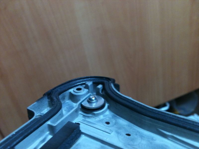

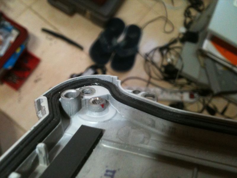

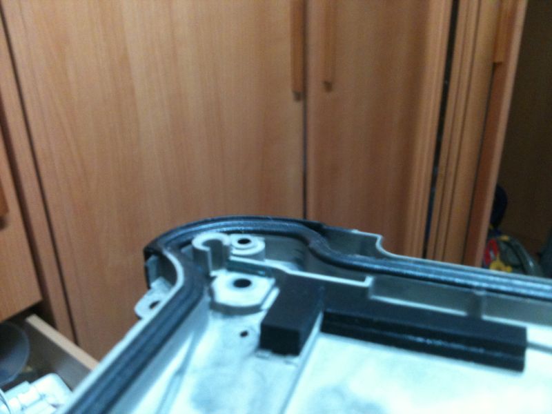

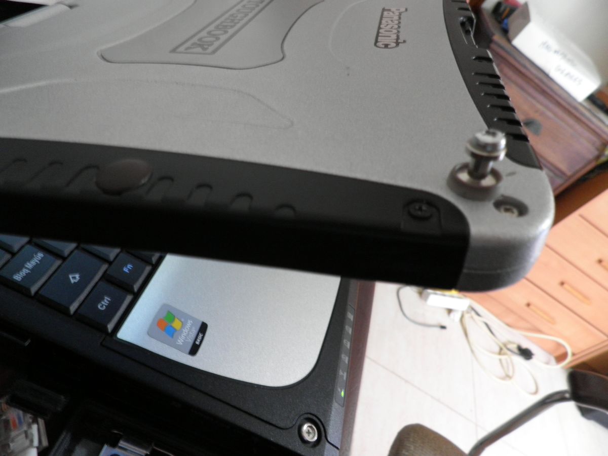

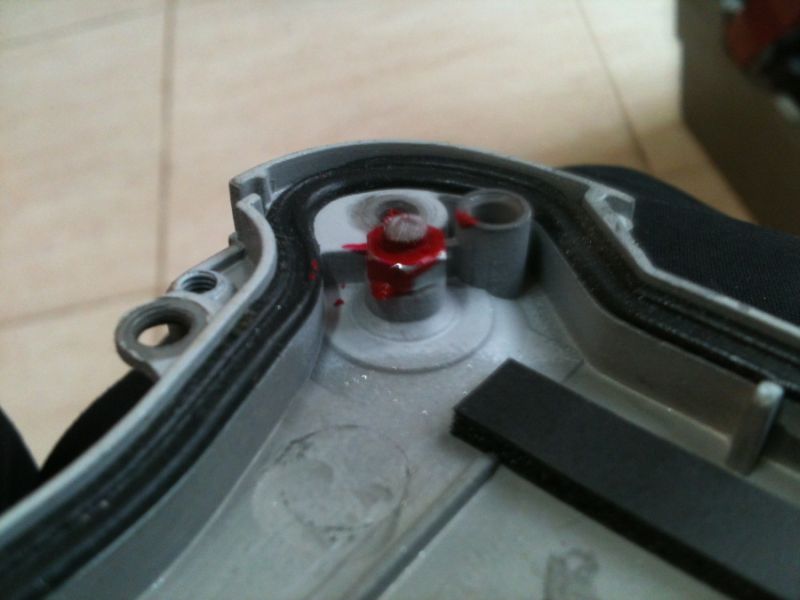

Ive opened it, pic 1 (screw1) is whats inside, the nut had threadlock on so was spinning with the screw and did not fall off, I took the nut off and was going to use just for now the screws and nuts from the Mk1 but they are not long enough as the inside of the lid is slightly different, pic2 (screw3) is the inside of the lid from Mk3 with the strange screws, you can see it got a raised collar maybe for extra extra strength, pic 3 & 4 (screw 5&6 ) is the inside of a Mk1, with, as you say the half moon nut its also flat where the nut goes on and not raised like the Mk3, so looks like Im going to need the screws that are long i enough to pass through to get a nut on the back

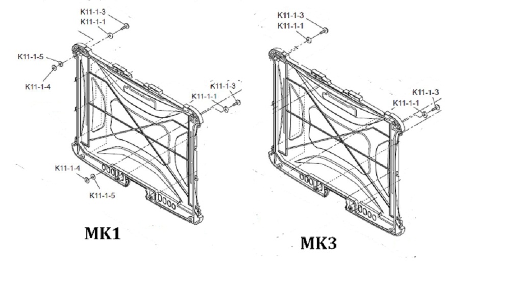

Have a look at the picture I took from the service manuals. Your MK3 is different from the MK1/2. Do you only need 1 screw or are both like that. The way I see it the MK3 has no nut...is that true ?
CF-19 LID.JPG (109.05 KiB) Viewed 33809 times

The screws all have the same part number K11-1-3 for the Mk1 & the Mk3! I do need both, yes the originals did have nuts on the back see here:
http://www.toughbooktalk.com/viewtopic.php?p=9287#p9287
