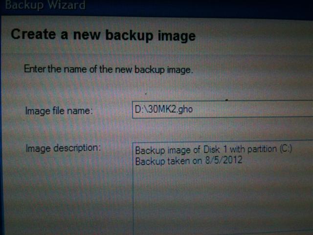

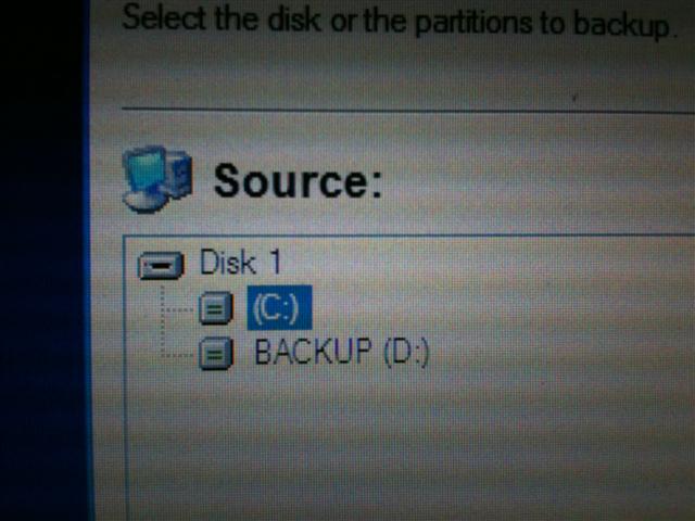

I can’t help with a network session but how about this…. Partition your hard drive into two drives like this…
C: Local Disk
D: Backup
Ghost C: to D. This works great. You can reimage in just a couple of minutes.
Nick
C: Local Disk
D: Backup
Nick
- 30MK2 B.jpg (46.84 KiB) Viewed 15612 times
