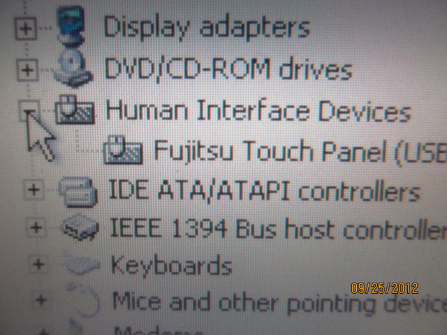

CHEAT SHEET FOR MARK1 CF-30
1. In control panel Human Interface Devices if two generic Human Interface Devices show up then you have a Vista Bios.
2. After flashing bios and setting to defaults Human Interface Devices shows one only device on the MK1 in my case Fujitsu Touch Panel (USB)'
3. If touch panel does not work at this point you have a bad panel or wiring.
Remember,
Mark 1 factory restore does not include touchscreen driver. Follow the instructions from http://pc-dl.panasonic.co.jp/dl/docs/00 ... &trn_org=2
When complete you will have a new directory c:\util2. (util2 indicates downloaded files, util indicates factory restore)

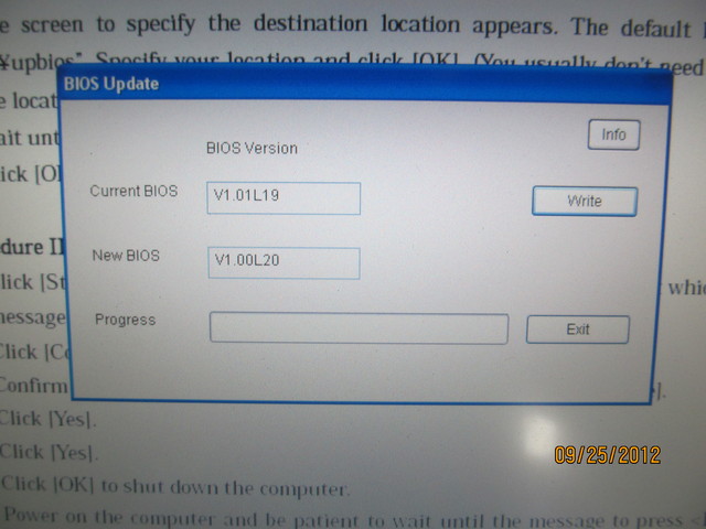

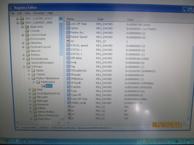

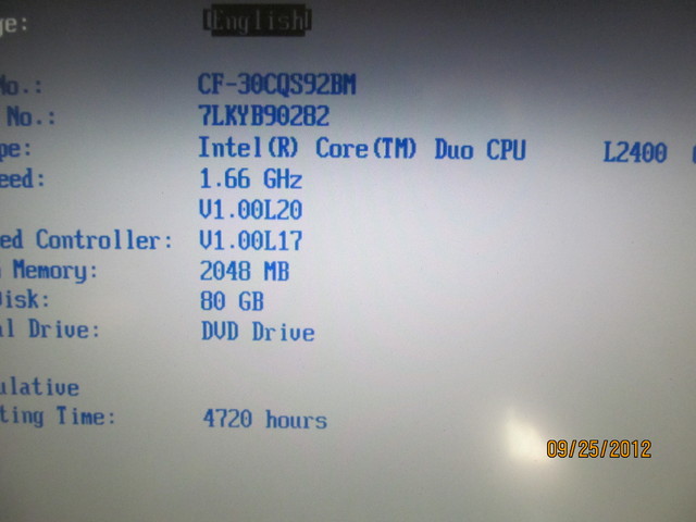

Working bios version for CF-30 XPP touchscreen is shown below. Also shown is the registry and a couple other pictures.
These are notes to myself of some stuff I have learned in the last month or so. For everyone else consider it FWIW.
Fire training...gotta go.
With Mark 1 after flashing the bios BACK to XPP I got the error so I:( Edit...what I meant here is that there are two bios flash gizzies in the link. one goes to Vista and one downgrades from Vista...read instructions from jp carefully.
1. Removed battery and power supply. Held key over three or four times to clear the mobo....I don't think this helped but this see below,
2. did.....F2 to bios set to defaults. On F10 Fujitsu panel showed up in Human Interface Devices.
In your case with the MK2 I don't see any bios tweaks at the jp site so you should be o.k.
Or do you have to tweak the bios for W7 for the Mk2?
Remember,

Jeff,I have HID-compliant device and USB human interface in my device manager,bios version V1.01L20,that's the vista bios I believe.
I have several dirt cheap mk1's that I am selling as starter Toughbooks so I will roll the bios back to XP,thanks so much for the info. I don't have any hair left to pull
Re: Jeff's touchscreen solution!
XP is L 20 L 17 Look for Vista >>XP
Vista L 20 L 11 Look for XP >>Vista (it's in the fine print.
You may need to boot twice...as it will clear the information on the mobo the second pass.....or do the power pull re-set.
It worked great,trying the second one right now.
