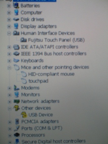

It's there under HID Fujitsa Touch Panel (USB) but farther down under other device...yellow USB Device. Now I have read this many times this same problem over at NBR but do you think I can find it now...no and it was always the MK1 with this same problem.Sadlmkr wrote: What's your [device manager] show under hid?

Well I may have a fix for it....well kinda. The one that the touch does not work on is a 19D but I also have a 19C which has the 18 top/lcd on it which the touch does work but thats all that works on the 18 top so my next job is to switch the top/LCD from the 19D and put it on the 19C. If the touchscreen is good then it should work on the 19C. Confused yet
- 1.jpg (59.23 KiB) Viewed 27912 times
