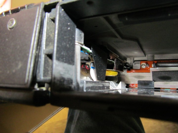

So it needs to be verified as plugged in (probably is) ooh ohh I have a picture. Shot through hdd door.
Shows where white cable plugs into mobo, cmos plug, cmos battery. I live near a dirt road.
Film is too honest.
- IMG_0056.JPG (69.3 KiB) Viewed 19273 times

Just got to work and peered in through Hdd opening, sure enough cmos battery is unplugged. Time for some disassembly.
Could this be causing the problems?

If you can see the plug you can plug it in from the door. It basically wants to point at the socket due to wires taking a "set" over time..... One screwdriver through hdd door one through the crack alongside the pcmcia slots....through pc door.

CMOS battery and touchpad inop--Seems odd, but Jeff, pull the CMOS battery on one of your working units and reboot without battery. See what happens. Prefer windows OS.
With a disconnected battery, it is more likely a ffc flat cable is not seated properly or the touchpad board has gone TA. Maybe touchpad ffc is upside down?
PS Much better. No gray..
