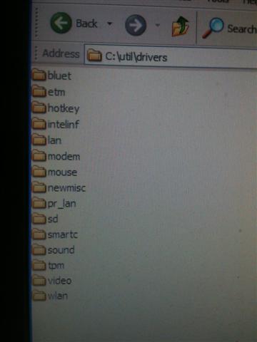

Re: Installed windows 7 pro 32 bit but says unknown devices?
Did you use the recovery DVD? Does it have Wan (Broadband) card in it? My guess would be Hotkey for one….This is not usually and issue when using he recovery DVD. Then maybe TPM Bluetooth and hd audio fax modem. Driver choices...

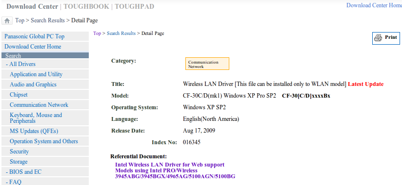

O.K. I'm talking XP here but my two exclamation marks were both "data interface".
Searched saw one advise to disable the WWAN. That wuddent it. (sic)
IN MY CASE(and this was last night) what it wanted was the Intel upgrade from the PANA jp site.
I downloaded the complete package since this unit is going elsewhere. Also down-loaded the instructions and went step by step. Worked and works fine now.
I remember upgrade packages for MK 3 and etc on the list too. (Mine was CF-30C)
FYI here's what I used.
