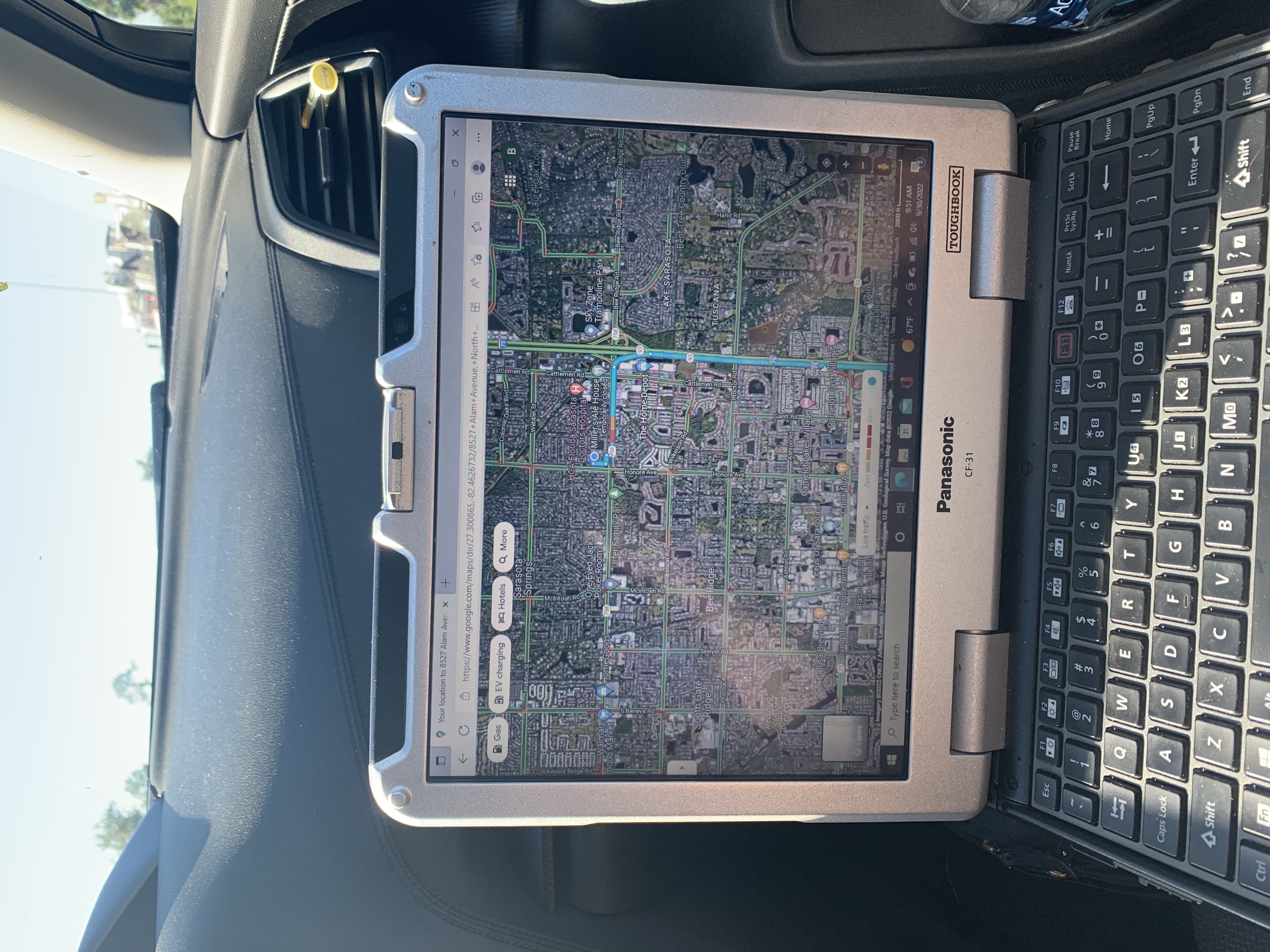

During the ordeal one thing I was longing for was stable internet. Currently I am on the Getac B300 and tethered to my iPhone. That actually is working fairly well. But yesterday tethered to the CF-31, didn't go well. The CF-31 is on W10, the B300 is on a broken W7 (it is screaming at me that it "might" not be genuine lol). Oh well apparently I am no longer connected. I have to constantly fiddle with the connection to keep it alive.
But I am definitely experiencing the "use case" for having a ruggedized laptop in s SHTF scenario. While I am fully powered up on a generator now, this B300 has over 9hrs of battery life. The CF-31 is pretty awesome too!
Here is where my real questions and lack of experience in this lie though.
1) The Tethered vs Cellular scenario. I would imagine the speeds to be comparable. But I also suspect that I will REMAIN connected with cellular where the tether drops out if I do something like write a long post... Or sit on Google Maps hoping to keep them live, but not actively doing other online tasks. If the cellular experience utilizing the Gobi or Sierra cards these all have is vastly improved on this current situation, I am probably sold on doing it!

I have tried a few of the Amazon and eBbay special cards! I guess I am lucky now in that the WWAN cards are already installed. I am just not sure it is worth it. I am currently tethered to my phone. It "sorta" works ok.
Not sure how to get the movie window player without uploading it to YouTube.
And even this much is barely happening lol!

You will get better results with the built-in card than tethered to your smartphone. I have a CF-31 Mk3 with a Sierra MC7700 that came from the factory with it. I don't use it much, but when I do use it, the result is like a home conn from a few yrs back. I have had better results with the Aircard than with some WiFi networks I had access to.
As I don't use the Aircard regularly, I don't have a 'data' SIM, I put the SIM from my cell phone into the CF-31, boot up the unit and input the Access Point Name (APN) for the network. Customer service for your cell provider should be able to give you the APN info and anything else you need to know to connect, or go buy a data SIM (SIM that is tied to a dedicated cellular data plan).
I should say that I use Linux so I am not sure about windows, heard that the conn manager handles the cell cards okay, no idea about Mac.
