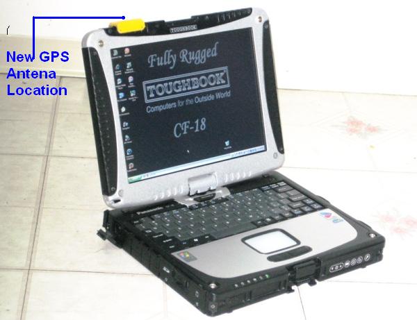

I've done a bet progress on Cf-18 gps by using the patch antena at the top fo Lcd. The result is much better than the pocket where the OEM antena located. I just need some finishing or maybe replacing the cover of the antena. It just happened the antena cover came from the body of my mastercraft tool box, Lol.......Teo

Teo, do u think you could cram a patch antenna into one of those wlan antenna covers from the 29? I don't have any antennas around me right now to try it out but I'll try later tonite and let ya'll know how it goes. I have like 20 of these covers and I would like to find a good use for them

The patch antena is to big and when it does. It is easy to break.
