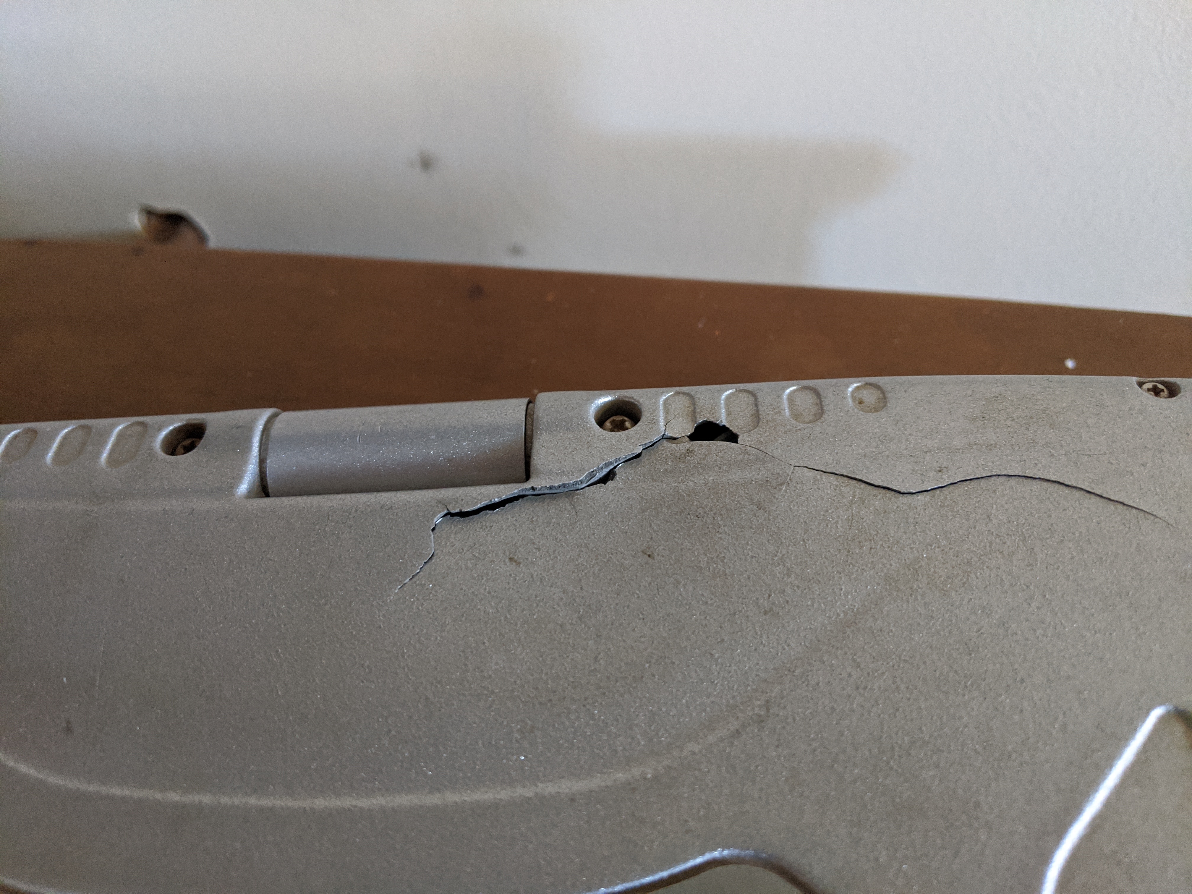

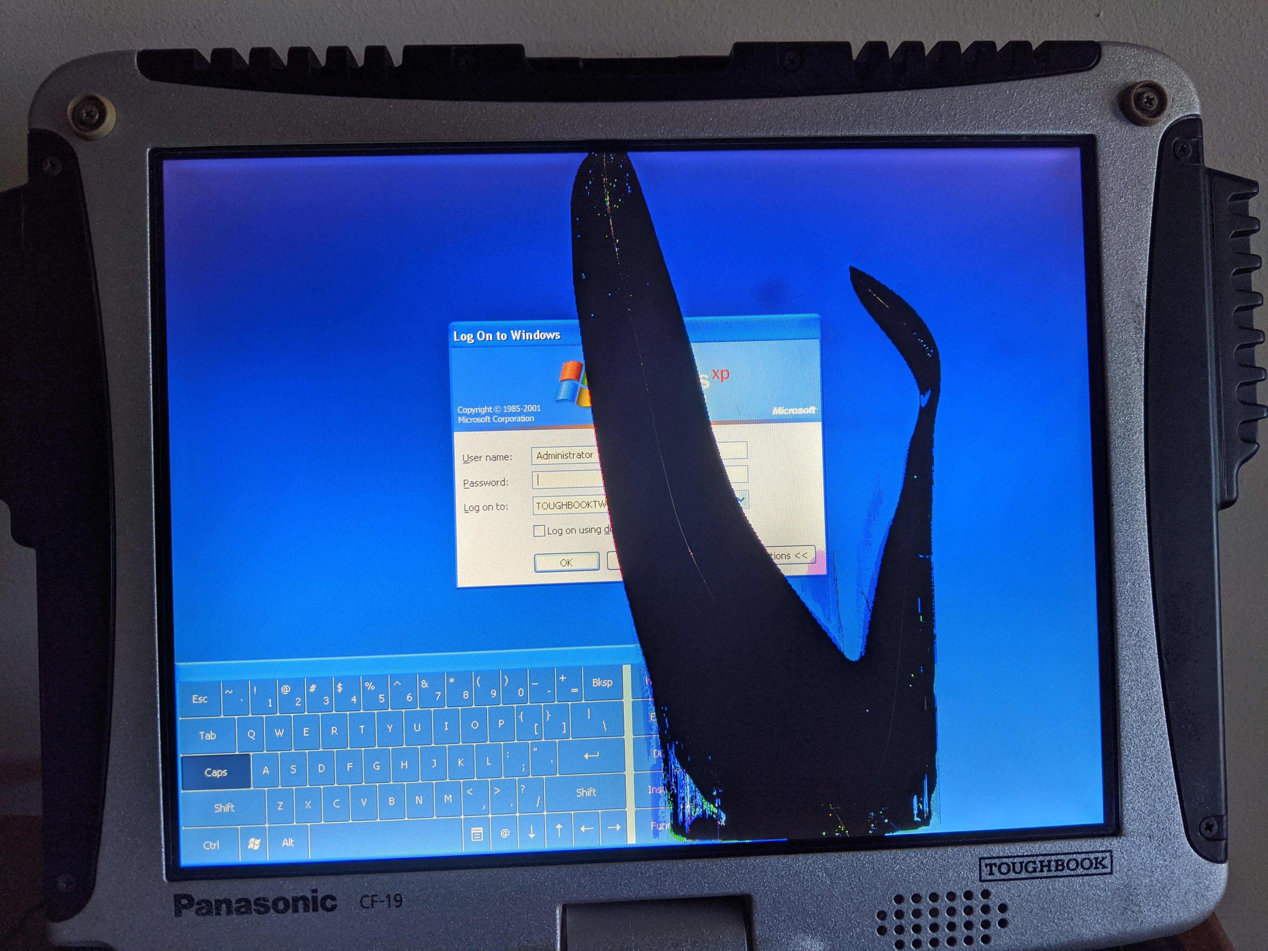

I have a CF-19 that I bought with a broken screen, somehow the outer case of the lid was cracked along will the LCD screen, but amazingly the digitizer survived. This unit turns on and everything seems to work.
CF-19KDRL66B

- IMG_20200702_085048.jpg (4.89 MiB) Viewed 24077 times
- IMG_20200702_085059.jpg (4.06 MiB) Viewed 24077 times
