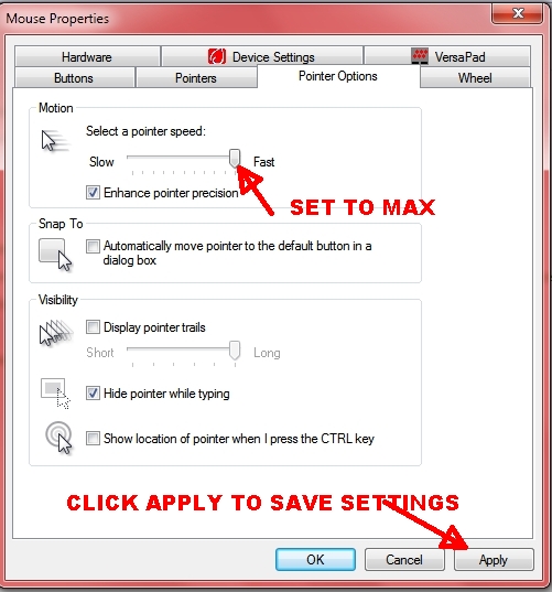

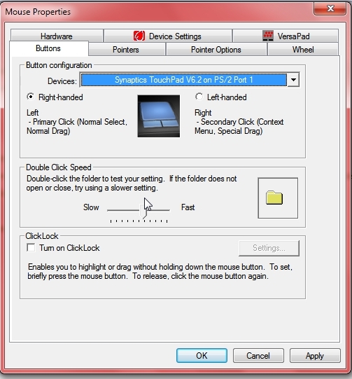

Try adjusting the sensitivity and speed in the touchpad application in the taskbar on the bottom right.

Before you attempt to mess with the touchpad hardware, try a software solution. Try a driver direct from Synaptics.
http://www.synaptics.com/resources
Then open the mouse//touchpad control from the taskbar or click MOUSE in windows control panel.
