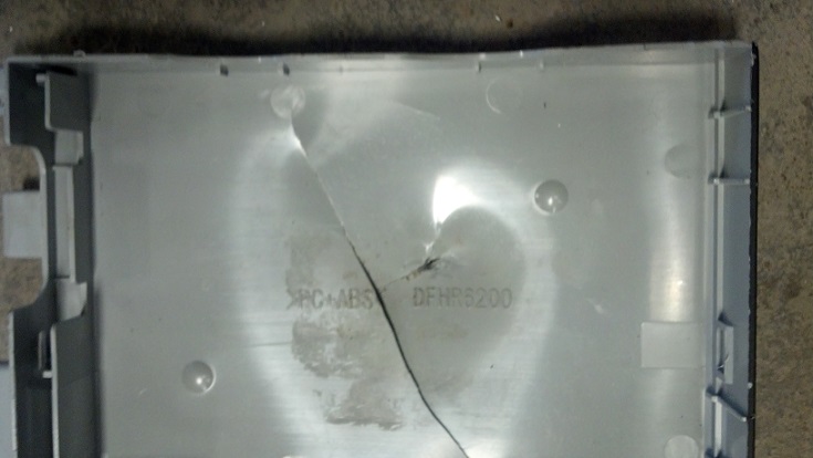

Well dunno about a big box of caddies but it looks like I can find 10 of the 19's out of an original 30 , 5 of the 74's that have NOT been DE-milled the HARD-WAY. That I can let find new homes. The hard way is a spike driven thru the carrier HDD and all crushed. I'll try to post a pic of what we call DE-milled the hard-way. An easy 20 dvd bays and I still have not counted the Power supplies yet.All are 74 & 30 type plug ins. I know there are more here. Unless like the wife thinks she might have thrown out "That box of junk". Sigh. Love that woman.

Here's a de-milled carrier that I'm actually going to end up using in one of my own machines. The first pic is of the aluminium side after I folded the hole closed and tapped it almost smooth.

Hope the pix aren't too big. Didn't realize they would be that big.
