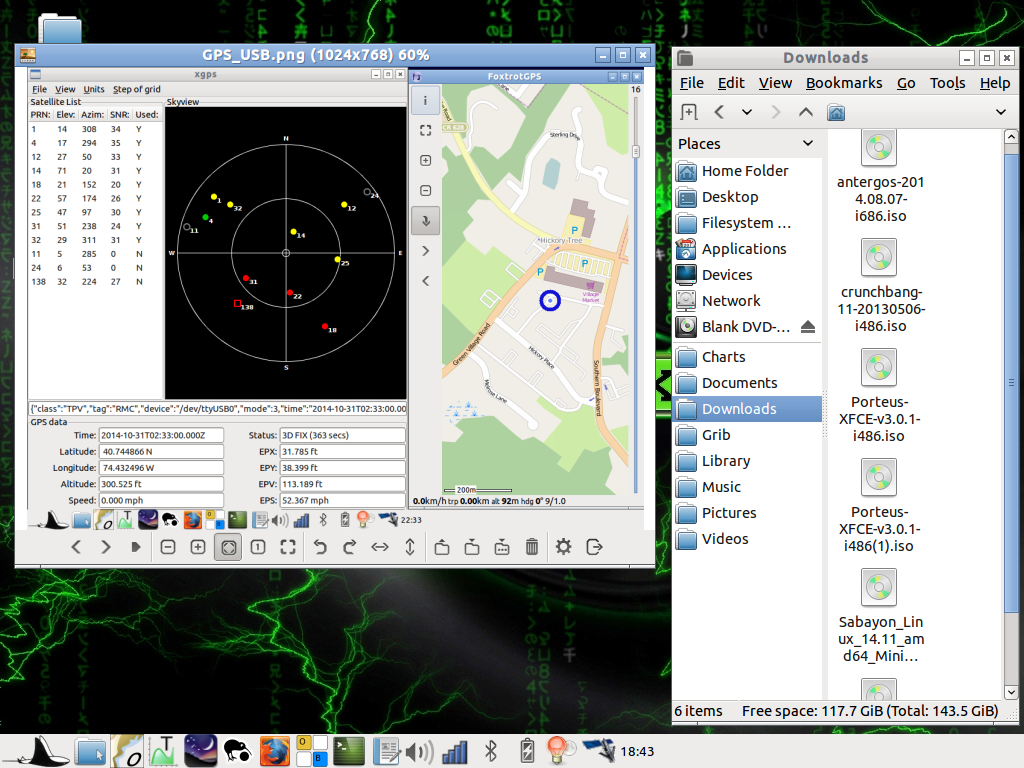

Now THAT'S interesting.
CF-30 MK 2FCS85AM
New install Navigatrix
Fiddled around for a couple hours and finally XGPS was showing the right words but no satellites....waited hours.
HERE IT COMES >>>>> Closed the lid, went in the house, came back out opened the lid and XGPS started working and locked on my location in three seconds. Repeated on re-boot BTW.
Question: What is lid closure doing? Is it buggy?
I see a butt kick script in the future.
