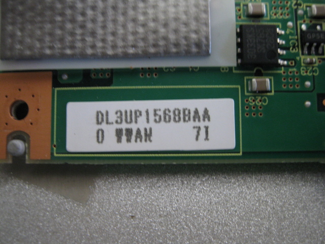

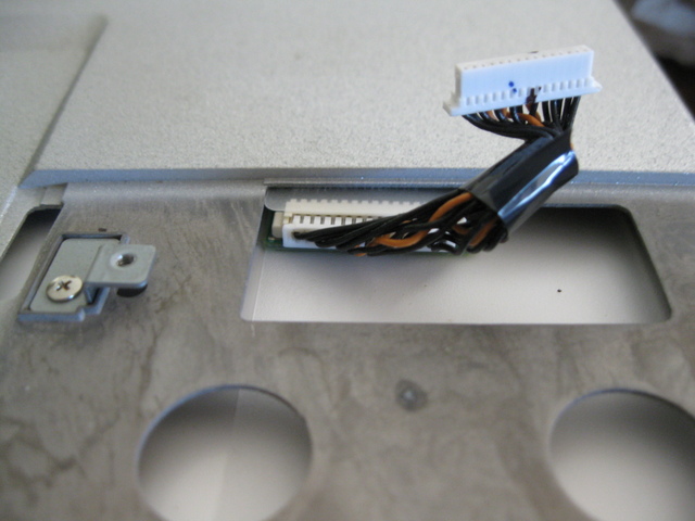

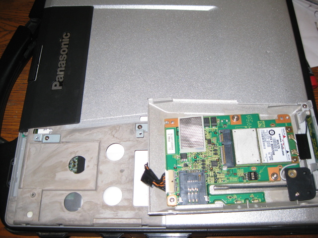

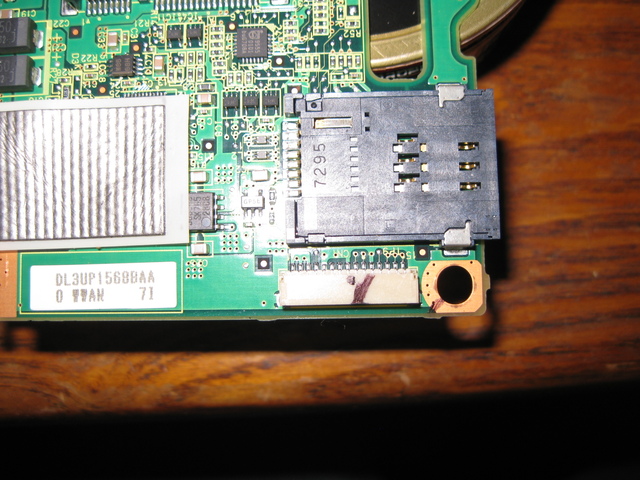

Here's some pics of the lid of a 74GCE01BM.
This looks a lot like the wireless cards on CF-29 and etc. It would be easy to tap into the correct wires. Now we need Teo to tell us which ones.
Hey Teo.
I'm thinking engine in the lid and antenna under the keyboard bezel as a start. Or antenna MAY fit in place of WWAN antenna.
I believe the non WWAN units have the connector installed. Anyone have a pic. I sold my E.
Jeff...distracted again...
p.s. does anyone have a 74 top lid. This one has a hole in it.
Edit added top two pictures.

- 1 on left 15 on right
- IMG_0087.resized.JPG (167.1 KiB) Viewed 18352 times
- IMG_0082.resized.JPG (102.3 KiB) Viewed 18353 times
- IMG_0077.resized.JPG (135.31 KiB) Viewed 18353 times
- IMG_0072.resized.JPG (165.04 KiB) Viewed 18353 times
