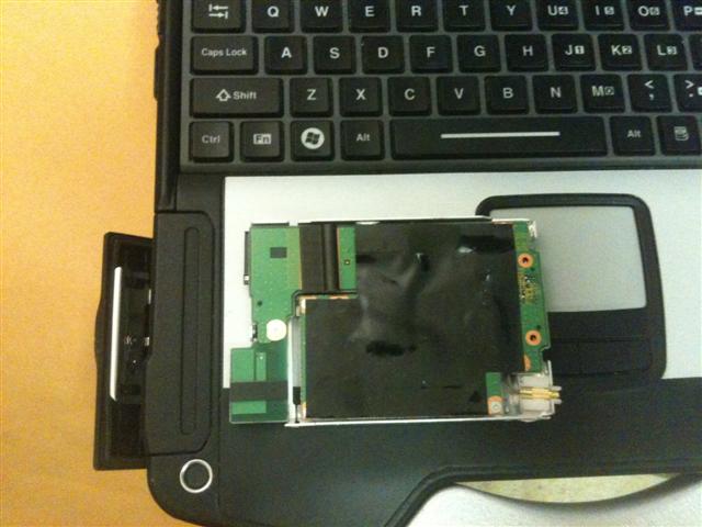

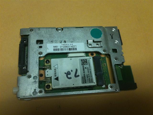

Hi all...So according to my model number on my new CF-30 (CF-30KQPAXAM), mine has a "wireless ready pocket". Does that mean that all I have to add is the gobi card and then use the verizon set up application or is there more that I have to add besides the card? I picked up an original GPS module to add to my 30, but it looks like the gobi cards also have GPS as well? Can you have both and would there be any problems/benefits to doing so? which GPS system is better? sorry for the rash of questions, but I have not come across a good description of the WWAN cards and how they work. :doh: If anyone has any hints on where to find more info on adding it and set up, it would be greatly appreciated. Thanks as always for everyones help :notworthy:

It means your only short the sled and wan card. It installs above the battery...Here is what it looks like..
Sled A (Small).JPG (40.82 KiB) Viewed 24850 times
Sled B (Small).JPG (50.19 KiB) Viewed 24850 times
