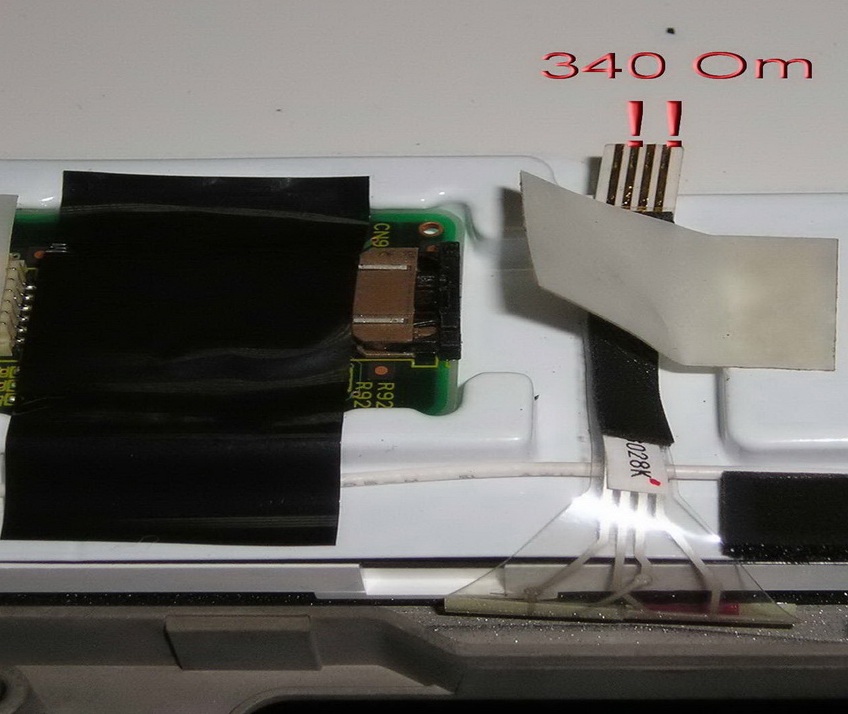

Checked the 4-wire touch screen
between two wires showed resistance Om 340
How much should it be?
touch screen is faulty?
Check the wires that are serviceable!

Check continuity between white plug on left side of this picture and plug under keyboard to eliminate broken wire as cause.
I don't know the answer to the question about ohms.
Best option to work a long time is new touch panel. http://www.ebay.com/itm/NEW-TOUCHSCREEN ... 336d8069b2
Good luck,
