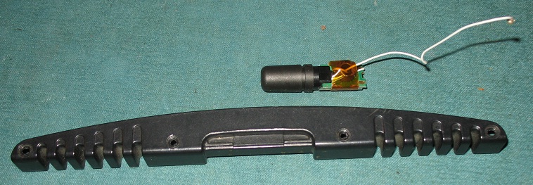

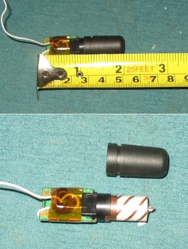

Teo , have you put one of these in the top before because there is no room unless you do some cutting . It can't go inside / back of the LCD because it will not get a signal if I am right. The antenna seams to be a little bigteo wrote:For your info, guys. It uses a sarantel antena. If you could dismantle that bug casing it will reveal the antena. Hope it has a radom black covering so that you can place on top of LCD. If it has only a plastic for internal let me know I have still spare radom black covering for sarantel. And yes! you can replace by a longer coax.
- GoBook 2 GPS 2.jpg (100.58 KiB) Viewed 20691 times
- GoBook 2 GPS.jpg (104.72 KiB) Viewed 20691 times
Re: GoBook lll 260+
toughasnails wrote:Teo , have you put one of these in the top before because there is no room unless you do some cutting . It can't go inside / back of the LCD because it will not get a signal if I am right. The antenna seams to be a little bigteo wrote:For your info, guys. It uses a sarantel antena. If you could dismantle that bug casing it will reveal the antena. Hope it has a radom black covering so that you can place on top of LCD. If it has only a plastic for internal let me know I have still spare radom black covering for sarantel. And yes! you can replace by a longer coax.
Blair! for the last three years I've abondoned on using that antena on CF-18. If you use that on top of LCD, It require a lot work and not worth it, coz it is to fragile. As of to date I use the taoglas antena, the 25dB with size of only 10mm X 10mm X 6mm which is perfect on CF-18/19 on top or the side plastic covering. The sarantel antena that you have will be perfect for GD Xr-1 if that is the sarantel S active antena or even on CF-28 and CF-29 but again. It needs a lot of work. Let em know how I can help.

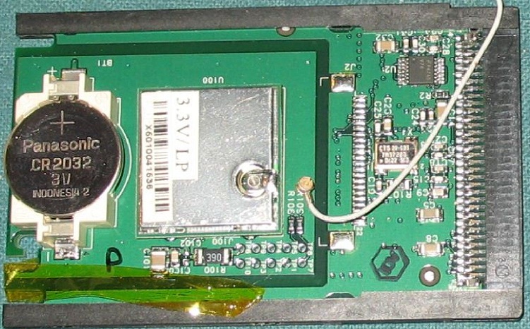

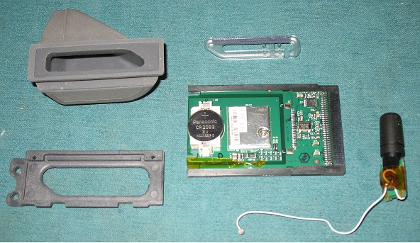

Teo here is some other pictures of the card and antenna. Hope that helps
- GoBook 2 GPS.JPG (174.15 KiB) Viewed 20634 times
- GoBook 2 GPS 3.jpg (85.57 KiB) Viewed 20680 times
Re: GoBook lll 260+
I beleived its an active sarantel antena and the connector on the module will be the standard u.fl connector. Maybe "Ken" can confirm that coz he has the same module.

I went to put the Gobook 2 GPS in my CF-19 two day ago. It won't fit because of the height of the card. You would have to cut or remove the metal plate dividing the express card slot above it to get it to fit properly.
This CF-19 is really nice shape and I plan on using it with my ASUS XG STATION, after I get windows 7 sorted out on it, so I will need the express card slot. I have 3 other units (cf-19 mk1) at home that are a little beat up but will work fine for some cut modding. This will probably be a problem on the CF-30 too. I didn't bring mine this time to work to double check. This still looks perfect for a older toughbook CF-25,27,28,29,18 that has the slot cover. It would just take up both pcmcia slots.
I waited too long and didn't order another unit so it looks like I am going to have to wait to get that second GPS unit. (Gobook 2 type)
Teo, On the factory antenna what do you thing about drilling the factory CF-18/19 GPS antenna hole out just big enough to slide the sarantel antenna though then putting a factory GPS cover over it.
