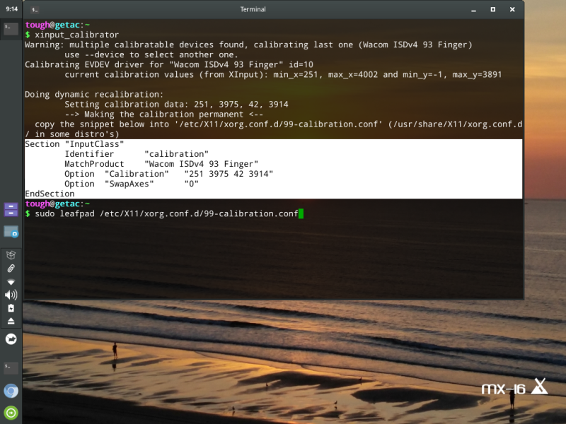

Here is a MK6 dual touch.....FYI....
Calibration from menu selected "fingertouch" screen also. This was my second run using terminal xinput_calibrator.
- ts191.png (450.68 KiB) Viewed 470290 times

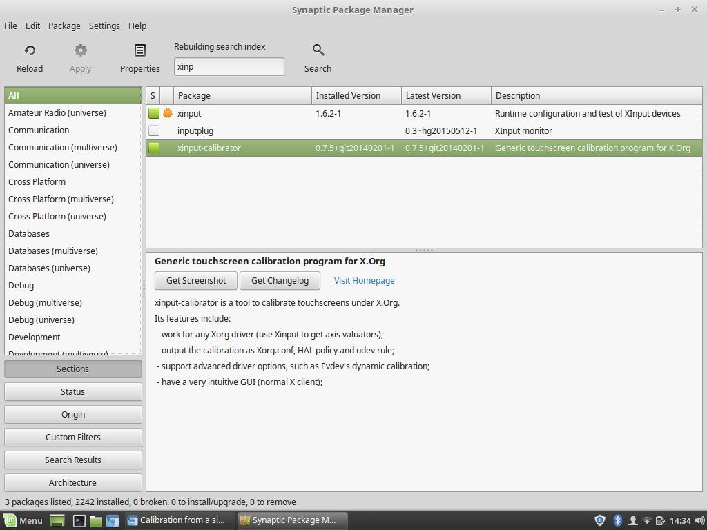

Re: Calibration from a single terminal.
I didn't have calibrator installed.
I'm gonna shut down and check bios settings. Meanwhile:
So after sudo apt-get install xinput-calibrator

I was thinking usb multiplexer confusion.
Mine is set auto tablet hence the different numbers.
Where did you get xinput-calibrator.....checking
