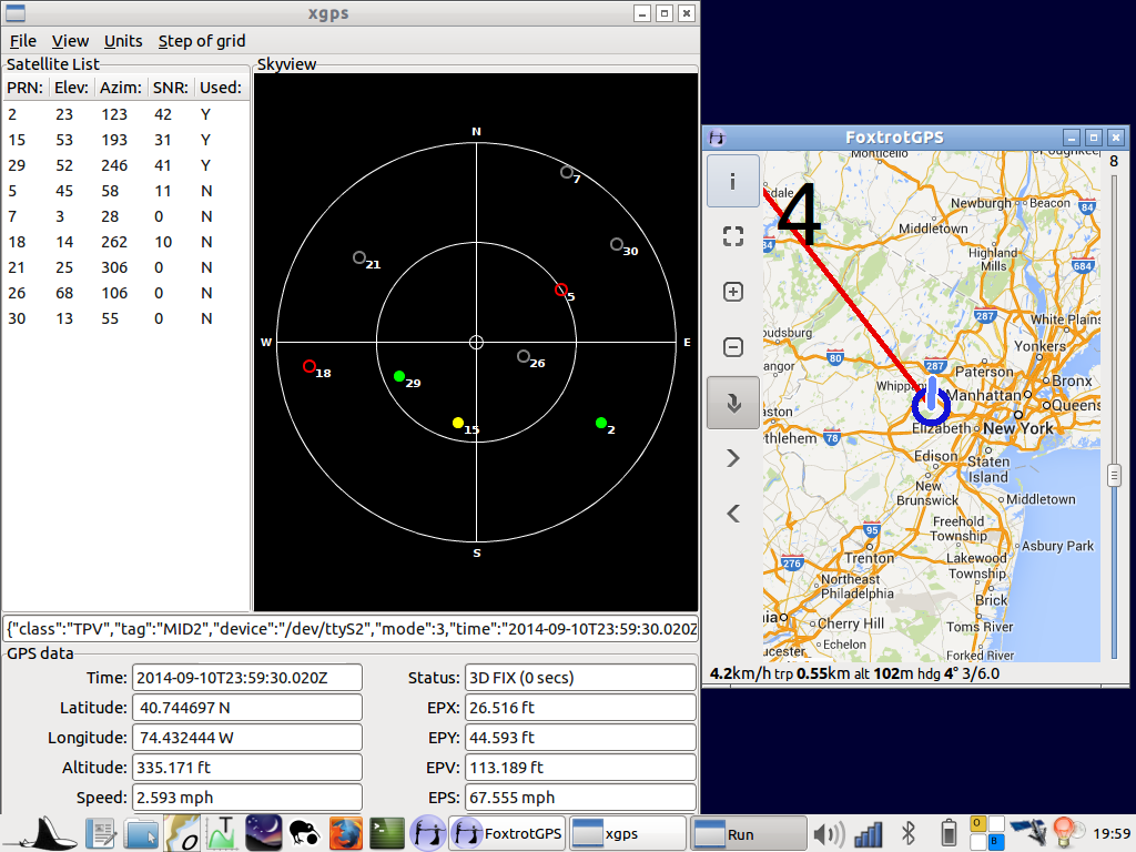

I got it to run on the Getec M220 as well!
Re: Linux boat navigation OS
Just downloaded and got her up and running on a MK1 CF-30
- Newest Nav Aug 2014
- 2014-09-10_195932_1024x768.png (309.49 KiB) Viewed 74158 times
