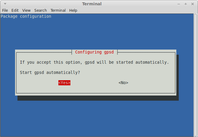

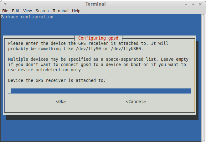

- Add your device here:
mine is /dev/ttyS2
capital S - Screenshot-Terminal2.png (35.53 KiB) Viewed 138170 times
- 1. Make sure gpsd is installed
2. Configure gpsd for your device
3. In Terminal, type this:
sudo dpkg-reconfigure gpsd
4. Use Tab key to hit ok and go to next screen
5. Configure your device and then save.
6. Tab to next page, leave it blank
7. Tab to last page, keep defaults
8. Save and exit
9. In Terminal, run this:
sudo service gpsd restart
Wait until it finishes and then exit Terminal.
I re-booted the computer and clicked on Foxtrot,
it found my position instantly on a CF-19 and a CF-30 with stock oem Panasonic Gps - Screenshot1-Terminal.png (21.62 KiB) Viewed 138170 times

Sorry about above screen shots, but when you configure/re-configure gpsd, there are three or four pages to go through. On the first page you would tab over to YES, and then hit enter. Next page is where you would configure your device. The nice thing is once you do this, at least for me, is that now when I turn on the Toughbook and click on FoxtrotGPS, it finds my position right away and displays a map. The settings would be different if you are using a usb gps or have installed yours on a different port.
I leave the third page blank, and the fourth page I accept the defaults, and then exit.
1. sudo dpkg-reconfigure gpsd
2. "configure gpsd (see above)" /dev/ttyS2
3. sudo service gpsd restart
4. re-boot system after you see OK in the terminal
