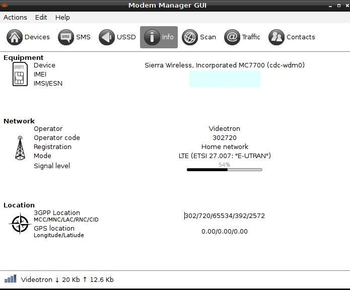

I finally figured out the Videotron problem. It really was the wrong APN.
It took a bit of black-belt googling to understand this one. To enable Network-Manager debug logging I found this command:
More useful info shows up in the syslog. In my case this is what caught my eye:
That led me to someone mentioning this being a generic bad APN error. I decided to try Videotron online support again but in French this time, and get a second opinion. It payed off. The guy told me that ihvm.videotron is the APN for 3G/AWS mobile internet. LTE uses ihvm.ng.
Now I'm no longer looking back! I'm sticking with LTE this time.
dbus-send --system --print-reply --dest=org.freedesktop.NetworkManager /org/freedesktop/NetworkManager org.freedesktop.NetworkManager.SetLogging string:"debug" string:""Code: Select all
gsm-wcdma-option-unsubscribedNow I'm no longer looking back! I'm sticking with LTE this time.
- modem-mngr-videotron.jpg (42.11 KiB) Viewed 15895 times

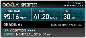

- videotron-lte-speedtest0513.png (32.29 KiB) Viewed 15885 times
