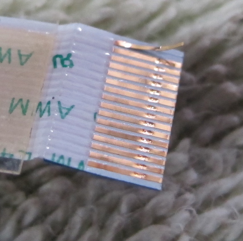

Ok, all is working now. Thanks to Jeff the touch screen is new and shiny. touchpad worked for quite a while then it would quit after being powered up for an hour or two. Checked connections many times. Even changed the the pcb the touchpad plugs into with no help. While I was changing that board for the second time (thanks Jeff for some parts) I noticed that the ribbon cable that goes from the motherboard to the touchpad board had a wire hanging off of it at the touchpad board. Installed "new" ribbon cable, and it is fixed. Let it run all night long (ran over 16 hours) and it works great.
Thanks again to Jeff for touchscreen repair, parts and knowledge. Thanks to Shawn too
