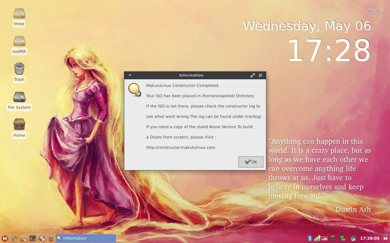

This Debian Linux version is 3.13.0-52, and it goes nicely with the CF-52 GUN that came out east from Sadlmkr's ranch. I re-booted and then ran the Makulu Constructor program. This made a custom iso of my somewhat vanilla system that I'd added browser, etc. It took 5-10 minutes or so, and then completed saying my new ISO had grown to around 786 MB, was now in the /home/snapshot folder. I'll burn a usb of this new iso tonight and let you know.

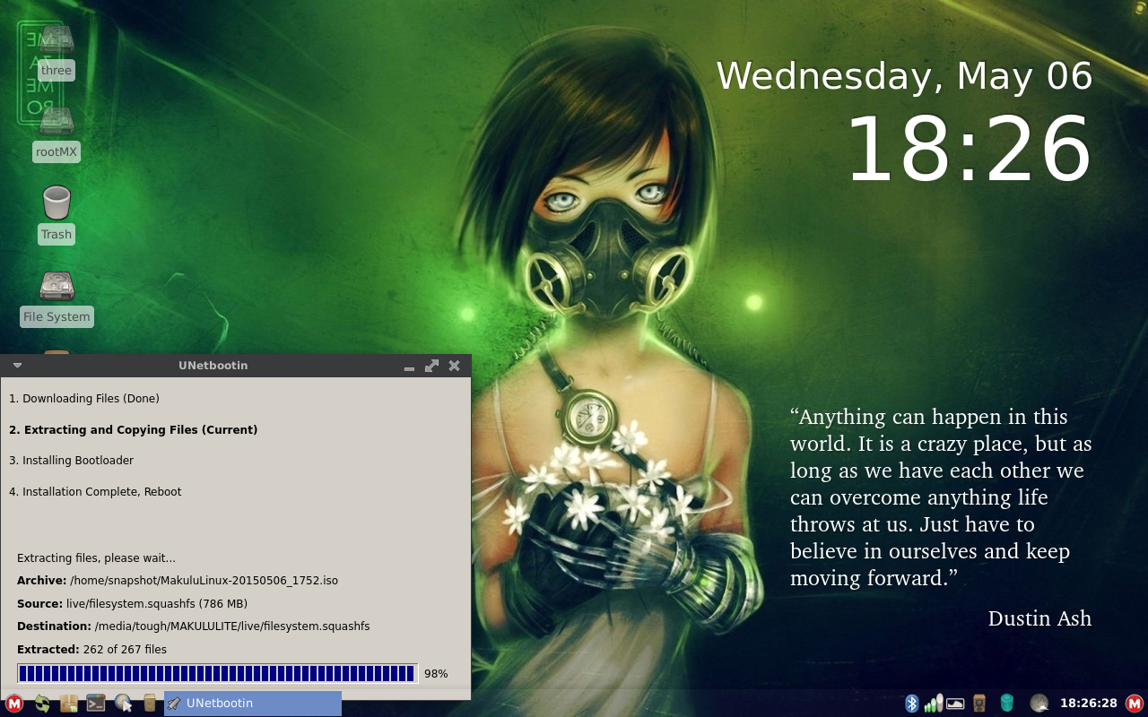

burning usb now
burning usb now
Workspace 1_003.png (999.9 KiB) Viewed 19509 times
screenshot of completed constructor program
Workspace 1_001.png (1.25 MiB) Viewed 19512 times
