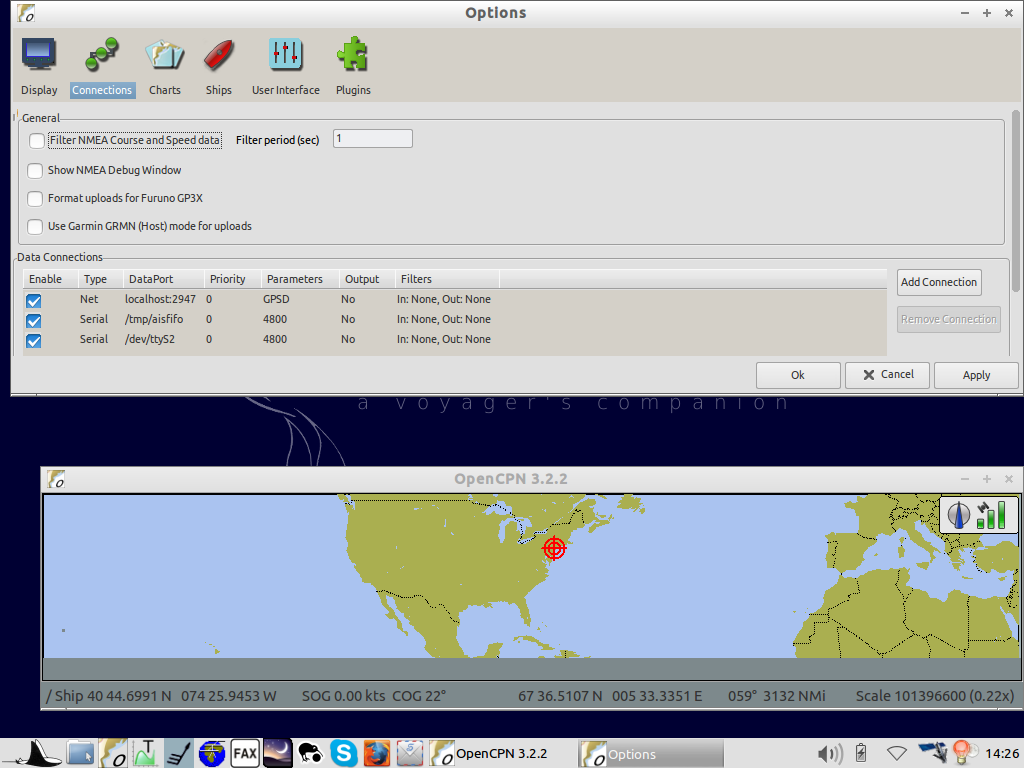

Okay, I´m on a ¨live¨ Linux (14.04) Navigatrix 0.5 usb disk, and this is with Jeffś MK2 CF-30FCS85AM, Bios V2.00L14, Embedded Controller V2.00L11, TS mode auto, status Tablet, All serial and parallel port settings set to Auto except for GPS, which I set to Enable, and chose: 0x3e8 irq 11, which I believe to be ttyS2 (com3 for Windows). I ran OPNCPN and went to top toolbar (wrench), options, connections, and added a connection. I chose /dev/ttyS2, apply, ok. Exited the program, opened it again, and the OPNCPN nav map program found my gps location. I had to zoom out to show the location on the map. This shows that the Panasonic CF-30 gps works off of a live linux disk and can show location. I do not yet know about FoxTrotGPS, nor XGPS, but at least when configuring settings for OPNCPN, the gps is in fact working. I´m going to try this out now on an extra hard drive and caddy. Best Regards, Cleve
Screenshot is of the OPNCPN settings page showing my settings and the map showing location.

You all have worked so hard to help me resolve this! I was going to get back to it after this test I have been prepping for! Based on your kind work I will now have to take part of the holiday weekend to try this! I had been content to tell myself that nobody has been successful in getting GPS to work under Linux on a Mk2!!! Sincerely, Thanks!

Not a problem, I know you're studying hard. It just bothered me, as it should be easy, right? I'm thinking that your fingerprint reader/bluetooth/or something might be conflicting with the gps while in your dual boot mode. This is as far as I got for now, I know it works on the above MK2, but you might have other options. I'm working on loading maps via FoxtrotGPS & OPNcpn programs, and will report back in the future. Everyone have a safe 4th of July, it's very wet here in the North East!
