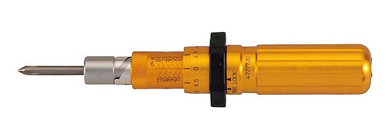

by Shawn
Tohnichi torque driver with interchangeable bits. Got mine on Ebay for a great price.
Must have for CF19//31 work.
- RTD60CN.jpg (12.83 KiB) Viewed 24315 times
