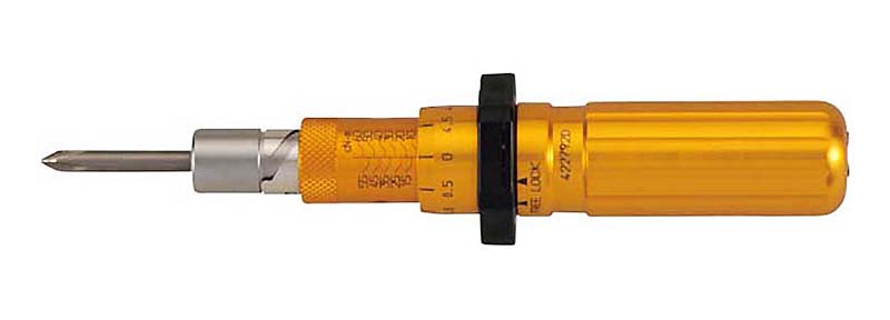

Tohnichi torque driver with interchangeable bits. Got mine on Ebay for a great price.
Must have for CF19//31 work.
