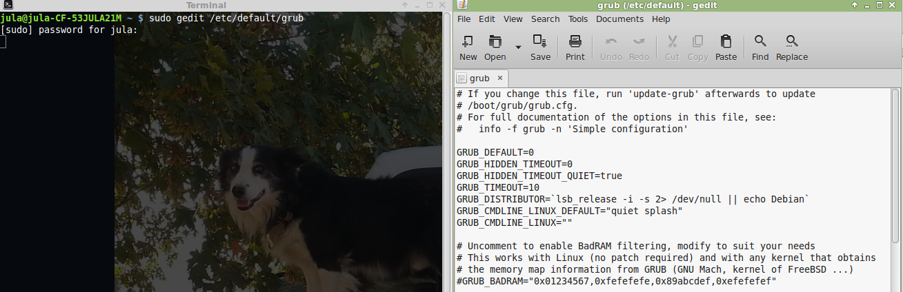

Re: Linux Mint on the CF-31
To test it put i8042.nopnp in front of quiet in grub menu. Works for one session. edit: Or after the quotes and one space.
gedit may not work<<<<<<if not installed....use any text editor like leafpad, nano ????
Access to grub menu is tab or e depending on distro.
I have some information in the Linux forum related to CF-31P. I'll find and link it.
Here is a quote that works for 31P that puts the information directly into psmouse.conf. Given as a general hint while I figure the rest out.
From terminal:
sudo echo "options psmouse proto=imps" | sudo tee /etc/modprobe.d/psmouse.conf >/dev/null
And this on the basics: https://wiki.ubuntu.com/Kernel/KernelBootParameters
Somewhere in this zoo I have a list of i8042 commands.
More later...chore time as the sun is going down.
