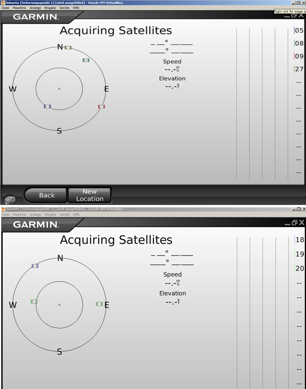

Re: SERIAL PORTS , COM PORTS AND EXTREME FRUSTRATION ON GPS
these three additional system.reg lines should enable com3 gps for garmin 5.00.70g
yesterdays dot net guess was wrong
not sure if the below mentioned mfc42.dll is required for garmin, it was required for some other gps tool
the gpsd and gps-client packages are only required for testing on linux. they have no benefit for running wine software.
how to reproduce:
does that work for you?
BR,
Karl Klammer
[Hardware\\Devicemap\\Serialcomm] 1231984861
"Serial2"="COM3"
"ttyS2"="Serial2"
how to reproduce:
karl@lubuntuvm:~$ sudo apt-get install gpsd gpsd-clients wine cmatrix
karl@lubuntuvm:~$ ls -la /dev/ttyS2
crw-rw---- 1 root dialout 4, 66 Nov 4 16:54 /dev/ttyS2
karl@lubuntuvm:~$ groups # verify I am in dialout group
karl adm dialout cdrom sudo dip plugdev lpadmin sambashare
# test gps on linux
karl@lubuntuvm:~$ gpscat -s 4800N1 /dev/ttyS2 | head -3
2681,E,0,00,50.0,551.0,M,47.6,M,0.0,0000*43
$GPGSA,A,1,,,,,,,,,,,,,50.0,50.0,50.0*05
$GPRMC,160734.957,V,4808.5437,N,01132.2681,E,0.0,0.00,041115,,,N*47
# symlink gps to wine and install mfc42.dll
karl@lubuntuvm:~$ ln -s /dev/ttyS2 /home/karl/.wine/dosdevices/com3
karl@lubuntuvm:~$ winetricks mfc42
# test with http://www.gpsutility.co.uk/files/gpsu524setup.exe
karl@lubuntuvm:~/.wine/drive_c/Program Files (x86)/GPS Utility$ wine ./gpsu524.exe
# does not work with GPS->Setup->Interface mode "NMEA " on com3 with 4800 baud
# does work with GPS->Setup->Interface mode "NMEA (via modem)" on com3 with 4800 baud
# install garmin thingy after extracting SFX EXE via 7zip
karl@lubuntuvm:~/Desktop/tmp$ wine msiexec /i GarminMobilePC_50070/MAIN.msi
# figure out garmin unit und unlock codes for SW.UNL
karl@lubuntuvm:~$ cmatrix
# run garmin thingy
karl@lubuntuvm:~/Desktop/tmp$ wine C:\\GarminMobilePC\\Que.exe
# garmin gps settings menu only offers usb and bluetooth, not com ports
# add these lines to system.reg, as garmin thingy seems to rely on registry stuff while ignoring IRQ stuff
> "Serial2"="COM3"
> "ttyS2"="Serial2"
# run garmin thingy again
# seems to work, altough takes ages for additional sattelites to appear
# did not get a full fix, probably as I am indoors ... will post update if/when that happens
BR,
Karl Klammer

- Karl Klammer
- Posts: 193
- Location: Old Europe
the number seems to be a timestamp
cmatrix is deep haxxxor shit, it will tell you the unlock code if you stare at it long enough ;-)
best #satellites I got so far was 5, without location fix
BR,
Karl Klammer
EDIT: I'm using wine-1.6.2, not sure if that matters.
BR,
Karl Klammer
