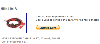

A few more characters.
- Capture1.PNG (17.87 KiB) Viewed 13744 times
