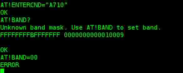

Re: FINALLY, ordered a CF-31
Looks busted. Well, I'm about to get an MC7355 and MC7455 to play with next week.
- bandmaskerror.jpg (5.28 KiB) Viewed 12271 times
