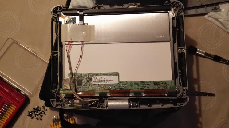

Thanks again Shawn,
Just took i apart. It looks slightly different from those elements that are on sale on Ebay.
Guess I just have to wait until it shows up.
Best Regards
//Lars
Best Regards
//Lars
- Tougbook.png (371.47 KiB) Viewed 15551 times

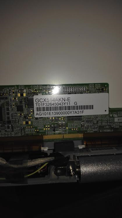

Can you post a closer photo of the sticker on the LCD.
Re: CF-19 LCD and touchscreen
Have been away for a few days.Shawn wrote:Can you post a closer photo of the sticker on the LCD.
Absolute Shawn, Here the picture!
- Sticker.png (221.45 KiB) Viewed 15537 times
Here is the exact LCD panel for $150.
http://www.aliexpress.com/store/product ... 18355.html
